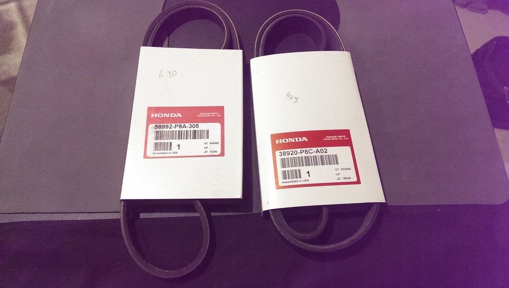

My drive belts / serpentine belts have been gradually noisy for the past few months at a cold start. It's becoming pretty obvious, so I need to look for the genuine oem parts. No Gates belts (for me).
Originally Posted by Sil2DrV6 View Post
Bought the power steering pump belt & the AC compressor belt for my V6.
Replaced @ 156K miles. Belts were showing a few spots of cracked surface layers. The compressor's clutch was also replaced due to its age.

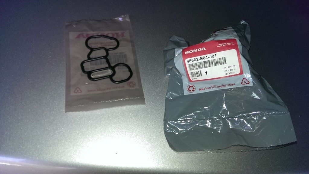

My oil filter housing is seeping, so I bought the spool valve filter. (AKA Vtec solenoid.)
Replaced @ 156K mi. At first, I thought it was just a minor seep, but I was recommended to change out the whole assembly (15811-P8E-A01) instead of just the filter itself inside. Was a good call b/c it really looked pretty bad 'n nasty when compared with the new piece. I can hear and feel the Vtec kicking in @3.5rpm like never before, and the car seems like it wants to accelerate forever. (Did a 0-60mph on a steep uphill mountain, and ended up in 80mph lol! ) The sound of the Vtec became almost like a cat in mating season, and it's loud AF. The valve can be completely shut now, so the low-end torque feels very powerful enough once again to be fully able to feel the need of changing shifts within 2 - 3 rpm range. When cruising on the road, car doesn't decelerate as much like how it used to be, when letting go of the gas pedal. CC system used to struggle to maintain a set speed but it operates nice 'n smooth on the road now.

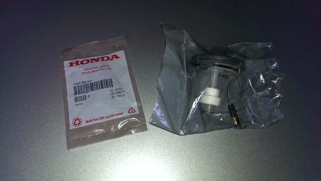

I also bought the brake fluid reservoir cap b/c it was leaking.
I remember that there was one time it gave me the light on my gage cluster, and it turned out to be that the cap was worn out and showing some seeping. (Thanks again for the indication at that time , Mr. Sketch o5.) One less thing to worry about.
