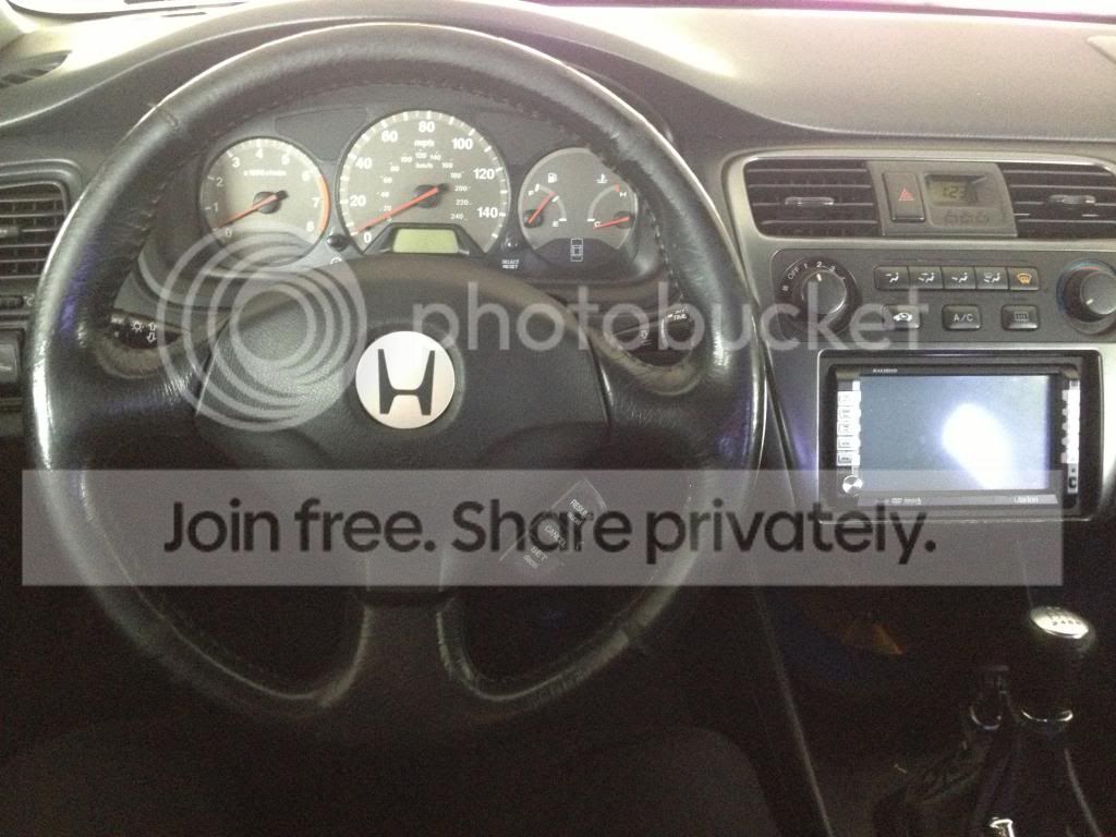

Need the guru's expertise on this issue.
I installed an RSX steering wheel that I purchased from Xxtankinover (thanks bro!) and followed the steps in the DIY thread http://www.6thgenaccord.com/forums/showthread.php?t=42151
I wired the CC as suggested in the above mentioned thread as well as grounded the horn. The process was very simple, but during the removal of the steering wheel, i somehow managed to pull the SRS Cable Reel apart :skurred: I was able to put it back together and pop it back in place.
But now as a result, my horn and CC isnt working.
Is there any way you guys may know of to troubleshoot this issue?

im no help, but just wanted to say that interior looks really nice with the wheel and double din

thanks!

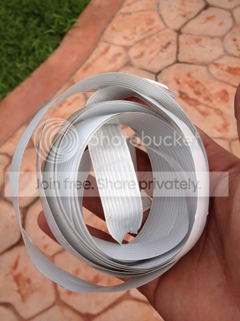

Update:
Removed the wheel this weekend and found the culprit. The wire loom inside the clockspring somehow snapped off.
Im gonna need a new one.

Lol Told you, Get an exact Year, and Model and Trim match, also be sure you pick up Single or Dual stage depending on your bag.
