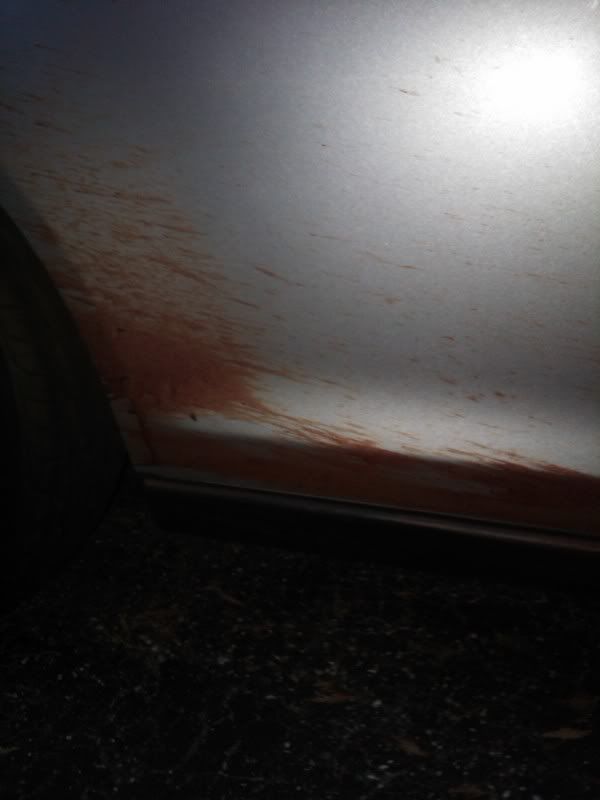

In for pics of blood splattered Accord.
Got a night shot, forgot to take pictures before I got the car washed, here's the best one, camera phone mind you lol
