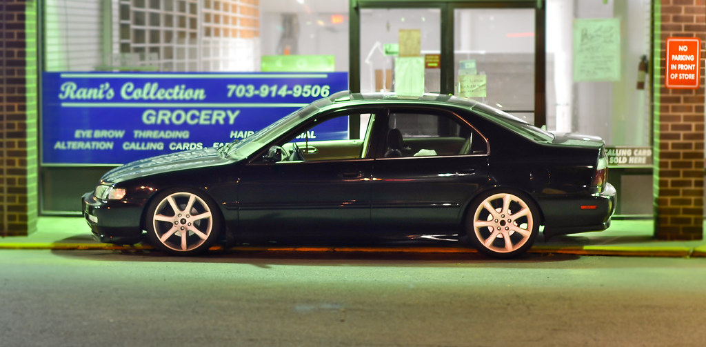

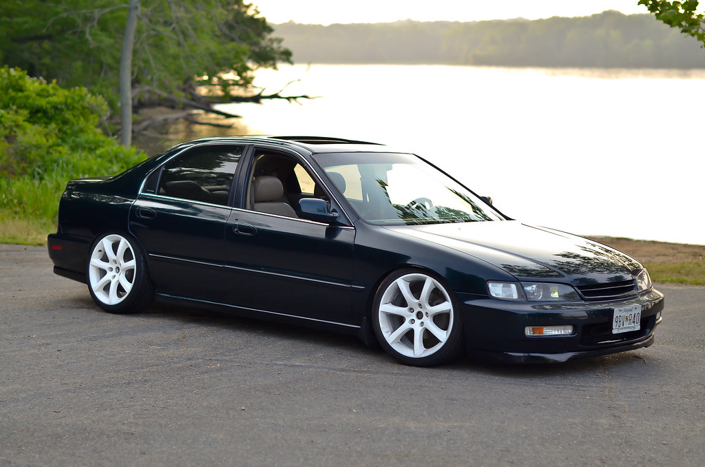

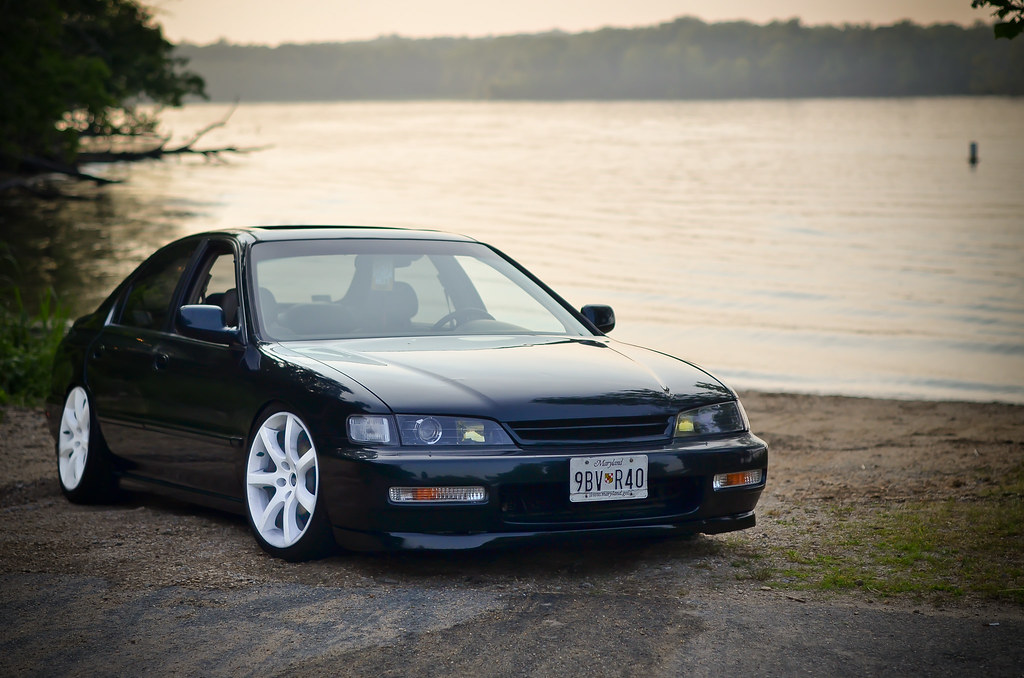

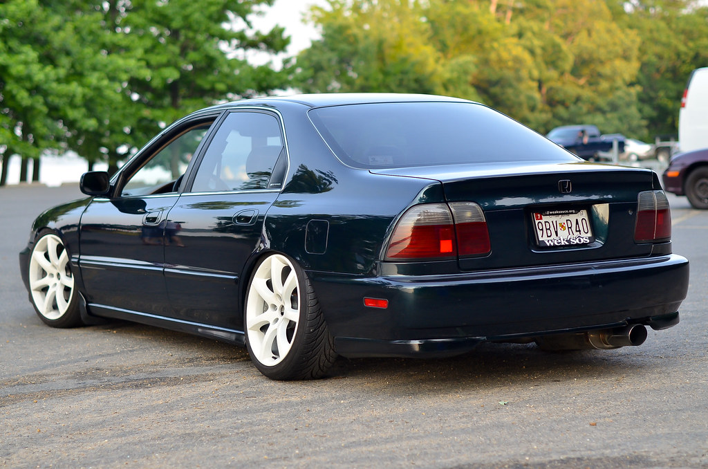

o Name: Balwin Singh
o Age: 21
o Model & Year of car: 1996 Accord EX CD5 F22B1 Manual
o Location: Easton, Maryland / Hyattsville, MD
I bought my accord back in June of 2006 as my first car when I was 16. I bought it from an wealthy elderly couple and it was their third car. When they owned it they had it professionally detailed at least once a month and had every receipt imaginable. It was their 3rd car that was driven by his wife. When I bought it, she had 128,xxx miles. I'm almost at 200 now and going strong as ever!
ENGINE:
F22B1
M2L5 transmission
Has a slightly shorter 3rd and 5th gear. Its from 4th gen lude w/ F22B1
eBay SRI pipes
AEM Intake Filter
H23A1 Throttle Body
Front Poly Mount Insert
P/S delete (NOT BY CHOICE.. LOL)
H23A ARP Headstuds
2.5" Catback Piping
Apex'i WSII Muffler
Manual Conversion
Clutchmasters Stage I Clutch
Spec 11 lb. Flywheel
Bonaco SS Clutch Line (From master to slave)
Shaved & Painted Valve Cover
WHEELS / SUSPENSION:
2003 Infiniti G35 Coupe wheels
215/40/18 Federal Tires
5 Lug/ ROH Swap (w/Odyssey knuckles)
Function and Form Type 1 Coilovers
Wicked Tuning Rear Camber Kit
NRG Front Strut Bar
Megan Rear Strut Bar
eBay Rear Lower Tie Bar
Front OEM EX 27mm Sway w/ Polyurethane Bushings
Grey ST Rear Sway w/ Polyurethane Bushings
Rolled Fenders with the rears pulled
BRAKES:
11.2" Brembo Blank Rotors
'95 Acura Legend LS Coupe Twin Piston Calipers
Goodridge SS Brake Lines
Rear 25mm Hubcentric Wheel Spacers
EXTERIOR:
Sherwood Green Pearl (G78P-3)
Chrome window trim blackout
Color-matched skirts
Reinstalled front plate bracket
Dual Filament bumper light mod. (92-95 Civic sockets)
Sold JDM mirrors
Sold CF hood
94/95 Front Grille
94/95 Front Lip
94/95 Rear Lip
JDM Accord Door Garnish
JDM SiR Bumper Lights
Genuine Honda Sunroof Visor
98-02 Accord Hood Squirters
(fan-like spray pattern as opposed to the standard 2-jet nozzles)
Fat Four Customs Battery Tie Down Bracket
LED Tail-light Retrofit
-Phillips Superflux LEDs (HPWT-DH00 Red/Orange @70ma)
-Slickraft PWM (HIDPlanet)
LED Tag Light Retrofit w/ Nichia K1 LED
LED Map Light Retrofit w/ Nichia K1 LED
LED Dome Light Retro w/ Nichia K1 LED
Debadged Trunk
INTERIOR:
30% Window Tint
Pioneer FH-P8000BT (double din with Bluetooth & iPod Interface)
92-96 Prelude Shifter Retrofit
92-96 Prelude Shift Knob
Future Plans:
Performance:
F23 Intake Manifold------------------------------------------>definitely
Megan header
Delta 260 Camshaft Regrind ------------------------------------------->maybe..
Chipped P06 converted to P28 with street tune on NepTune-----> maybe..
Suspension:
Ultra Racing 3 point strut bar -------------------------------->definitely
Tanabe front underbrace
Polyurethane dust boots and bushings
Hard Rubber rear lower strut bolt bushing
New sway bar or get mine fixed (center piece broke off)
Aesthetics:
Redo the retrofit with Depo headlights and different projectors and shrouds.. I wont let that out of the box just yet.
Wetsand the clearcoat.
Repaint G35 wheels (white again.. the current finish is screwed).
Sell 25mm spacer and buy a 15mm spacer for the rear and an 8 or 10mm spacer for the front.
Maybe a rear window visor to compliment the sunroof visor.
More LED retrofits
Acura Legend Lip DIY (bought, not installed)
Maybe Sideskirts
Maybe Rear Lip
