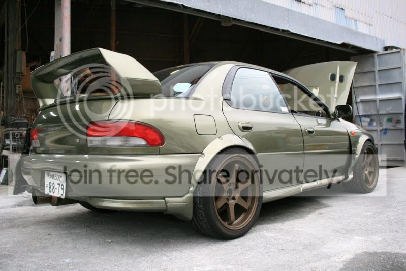

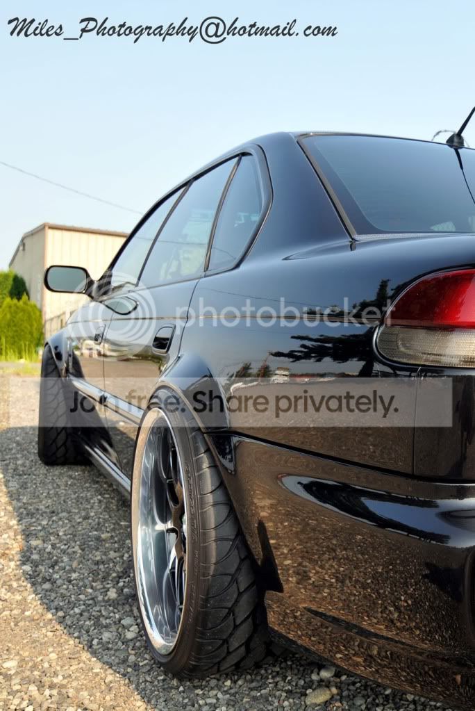

It's been done on Honda's/Acura's and can look great. I don't think the rivet rocket bunny style looks good on our cars, but properly welded on flares with wide wheels look amazing.

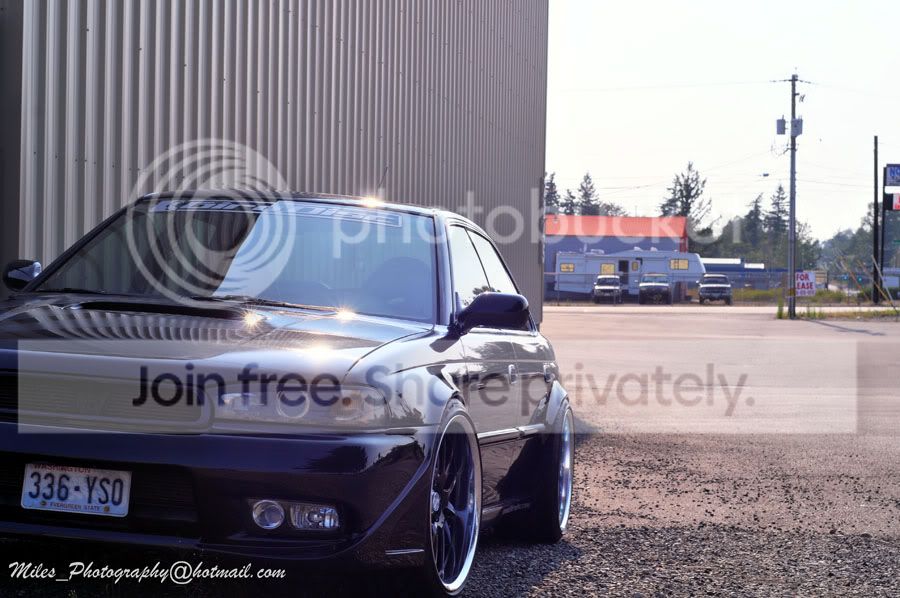

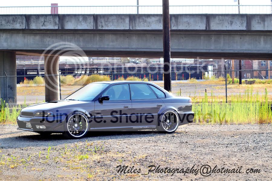

I'd advise avoiding this look on our cars, though it looks fine on Subarus:
