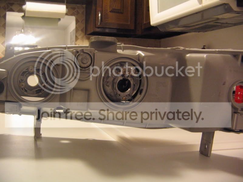

do you have pictures of the backs of the reflector bucjets?

I'll snap one

Re: WHAT!?!?! Chido's doing a retro??? (56k warning) **UPDATE!**
Nothing is adjusted yet all the set screws are threaded to the end as a starting point.
how far out are your projectors? cause i had to cut the backs of mine.
Not very far the back of the 'bowl' of the projector is at the hole. After looking at the projector, i might cut into the bottom of the reflector bucket to except that bump on the bottom of the projector that the cutoff shield screws into so i can mount the projector lower and be able to have a wider range of adjustment. We'll see if that makes the projector sit too low in the housing, and hopefully that won't effect the light output.
It's actually not that difficult. I thought it would be harder. You can do it man, all it takes is patience and the ability to follow direction.

agreed. it's like sidemarkers you just gotta balls up.
and thats what i did with mine. i cut the bottom out.
