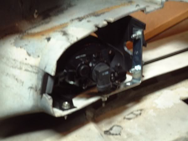

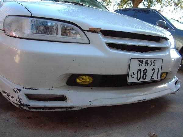

dynasty
Jul 7, 2006
2,515
all you need is an L-bracket. mine was pre-drilled which fit into the holes perfectly. next is to cut the side. after that, i just use a bolt and screw from the L-bracket into the bumper. then a big screw to drill the other side down. that's about it.
for the electrical stuff, all you need to do is find the trigger wire and the power wire. power wire is yellow, i believe. after that, the trigger wire should be right next to it. splice both wires, wire the trigger wire to the corner lights, and the power to the battery. as for the button itself, it will not stay into the original spot next to the cruise control button. so i modified mine on there. that's about it! if you guys need help, let me know so i can post up more pictures.
