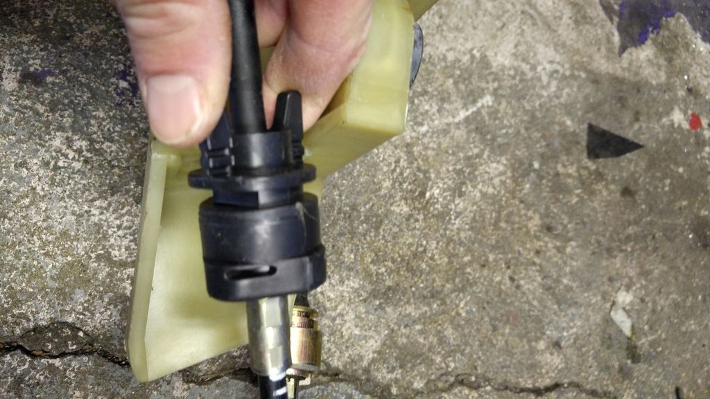

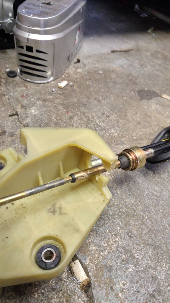

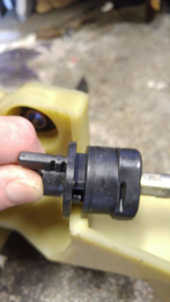

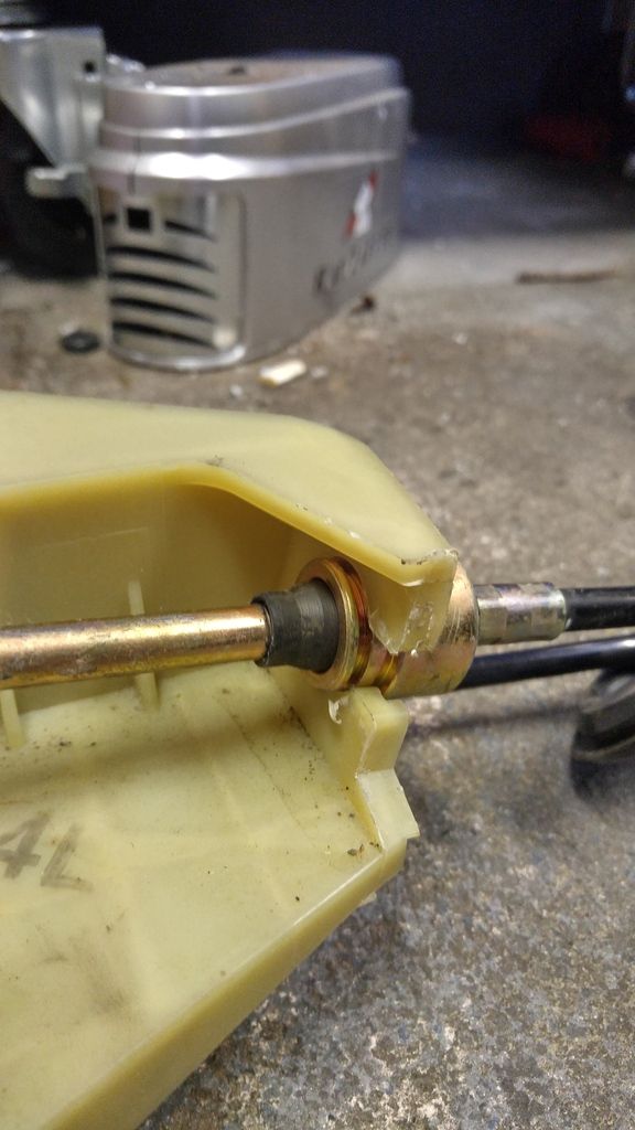

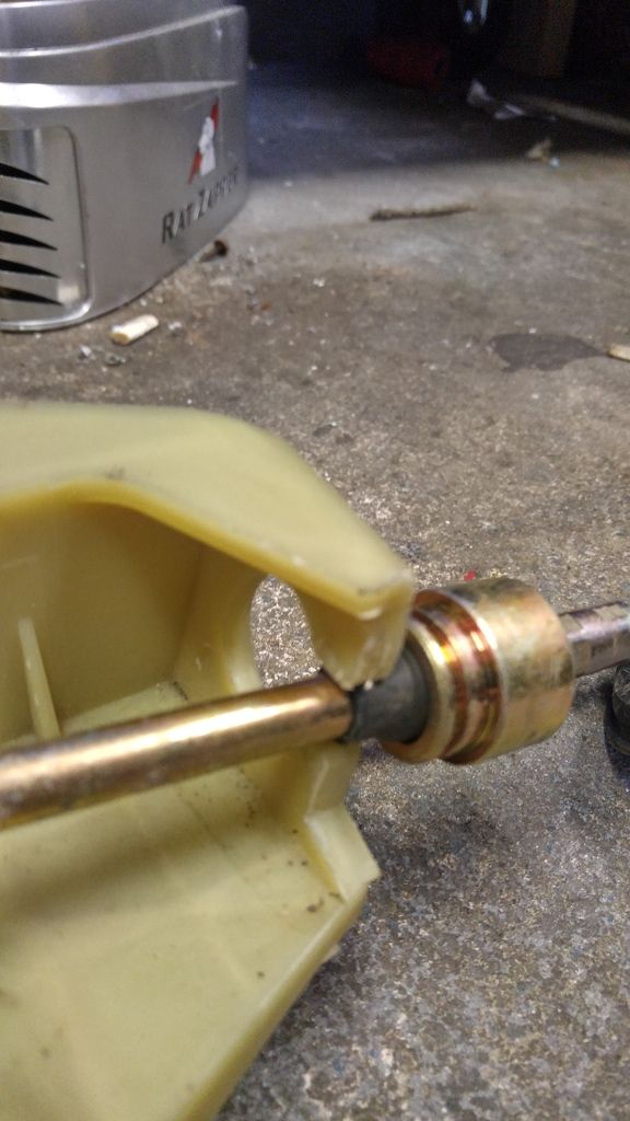

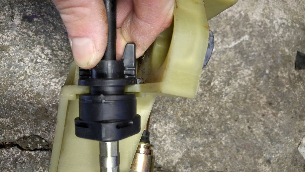

Re: phi1542's 02 Coupe 5-Speed
This one goes in this way
And then pull it threw
Here's where u will clear up to
This one only fits one way. You gotta keep spinning it until it slides in
Fits here
Wont fit this way
Hope this helps ya
