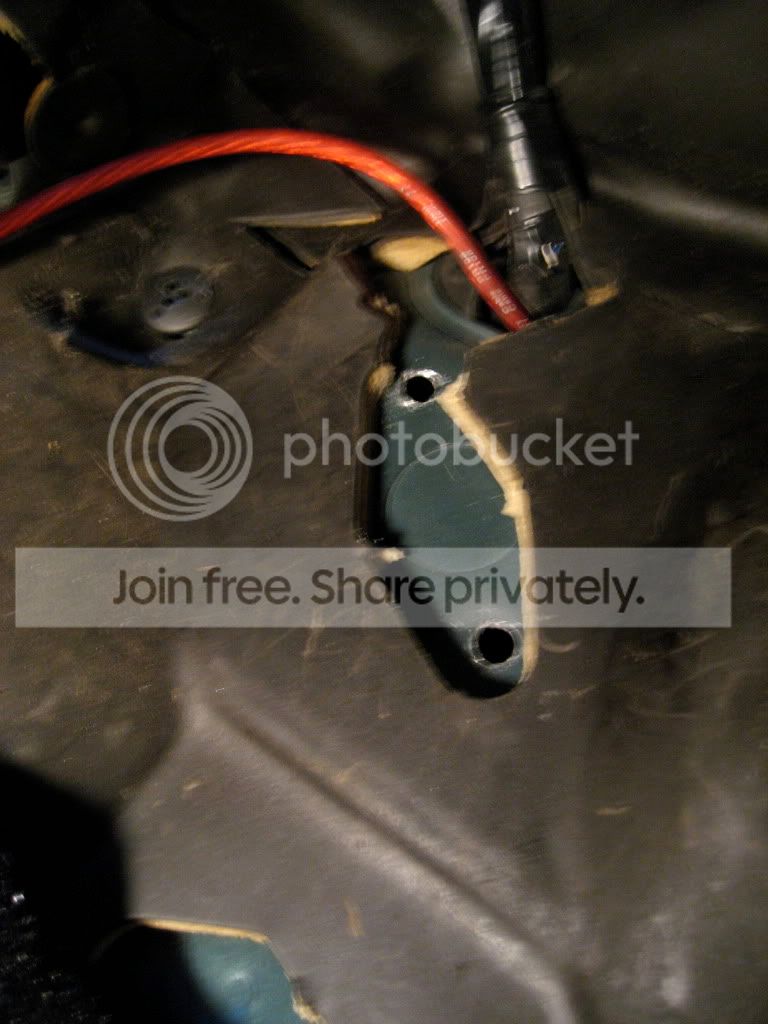

Got the clutch pedal/master cylinder in, along with the reservoir for the clutch lines...
Cutting holes

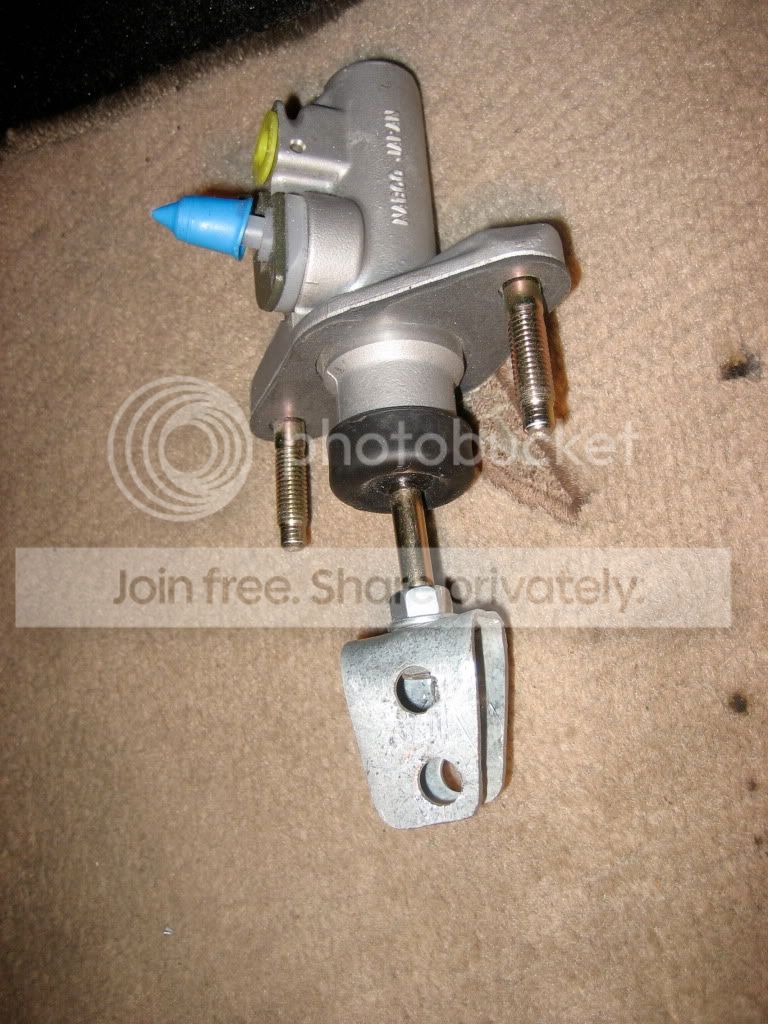

I had to make a clevis for the master cyl. since it didnt come with one. Its ugly, but it works.

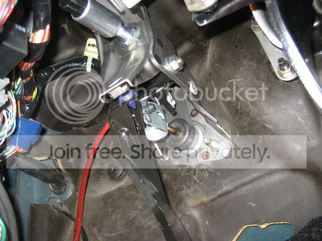

Master cyl. through the firewall
Pedal hooked up

did you put spacers behind the pedal? If not you're gonna need some

I didnt' realize you had to put spacers in, so I took care of it today. Found 10mm collar spacers in my junk and used those, and made a new clevis since after putting the spacers in it didnt work properly (just made a longer clevis) Everything is in now, the pedals, master cyl, and reservoir/hose.....ran out of things to do until the motor is out :(
I would recommend against using the collar spacers. Use a build-up of fender washers. You can get em at home depot. If you stay with a washer with a small diameter there will be less surface area to brace the pedal and after about a year of use the pedal bracket with warp and have stress cracks (i just went through this).
Also be sure to brace the top of the pedal to the steel dash cross member, this will brace the moment force put on the bracket each time you clutch. This will save a ton of headache down the road.....
the collar spacers arent wide at all...I noticed the top of the clutch pedal bracket needs support, just like the brake pedal has. How did you support the pedal?
