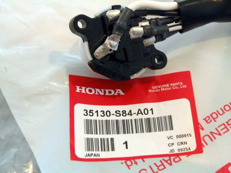

So which switch is it? I see in the OP's post it says, "The ignition switch P/N 35130-S84-305 or Click this I'll play nice. This part is for a 98-02 Honda Accord ONLY (for other viewers non-6GA)", but when I search at Majestic it shows part number 35130-S84-A01, as seen here: http://www.hondaautomotiveparts.com...LX&catcgry4=KA4AT&catcgry5=COMBINATION+SWITCH
So am I overlooking something or what is the problem?
