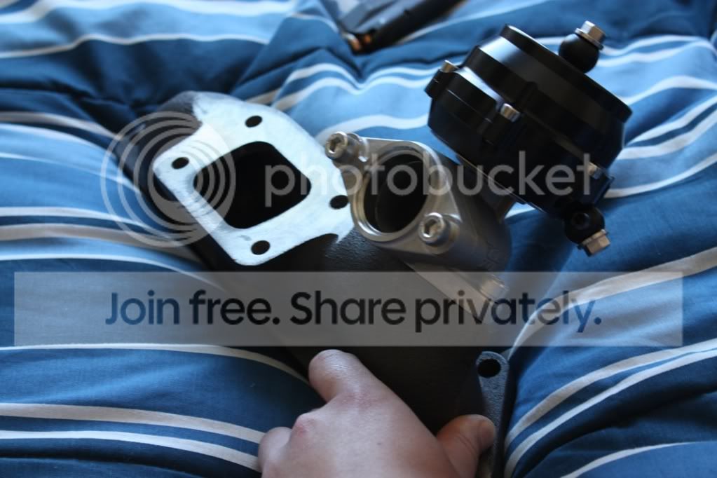

Hey everyone. I don’t post too much on here but I do use the forum for valuable information for my 6th gen. I have laid out a list of parts needed and begun to purchase a few for a turbo project. That being said I do have a few questions regarding the project that I was hoping the gurus on here might be able to help me with. I have done lots of research on here and the other Honda forums about most of these question topics but just want to get for sure answers to some things so I can continue collecting the right parts. My car has been properly maintenanced throughout it’s life and is in good condition so this will be budget build and not a tear down and build the whole engine kind of project, although I would love to… I just want a little more fun out of mine and bear in mind I am a full time college student with a part time job and rent payments so it will be an extended process.

Proof!!
