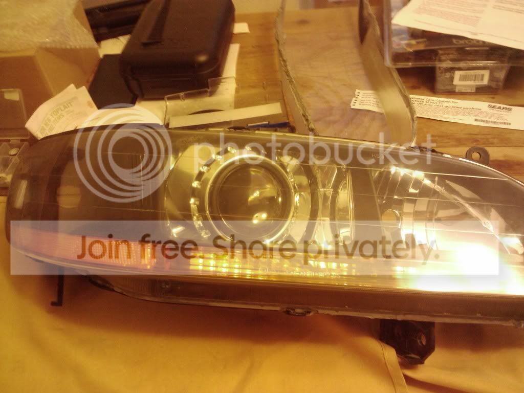

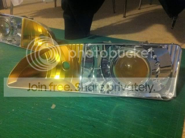

This was my first retro fit with e46 shrouds I did
Then I went ahead and did a quad retro fit with the same projectors and e46 shrouds as you have. Just work on the dremel and don't rush it
with an aftermarket crystal black lens
