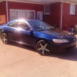

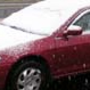

If you have wide wheels and don't lower your car not only will I facepalm but so will the rest of the world.
Here. (Snoop face pending..)
Sry, OP. Didn't mean to thread jack, but this is a good example of having aftermarket wheels without dropping the height. AKA, 4x4 SUV spec.
