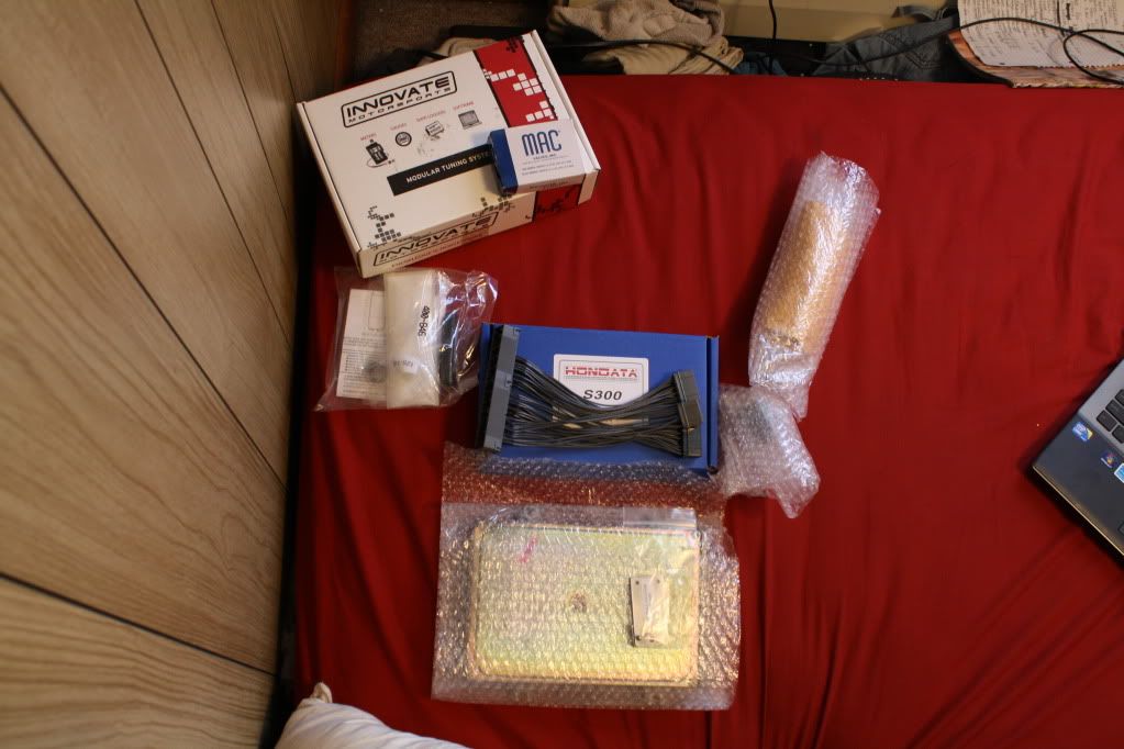

UPS just paid me a visit :D
Hondata s300, Hondata 4bar mar sensor, obd1 conversion harness, hondata PWM boost solenoid, walbro 255, Innovative LC-1 and DB red gauge wideband
DSM 450cc injectors, blitz bov, godspeed cast iron manifold and t3/t4 to TD05h adapter.
obd1 resistor block, and 2 wire IAC
autometer phantom boost gauge

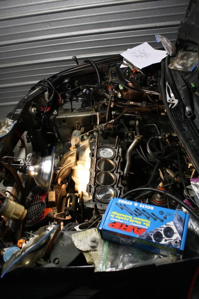

Just got the block back from inline pro. had it bored and honed to fit my new 86.5mm CP pistons. Also the new turbo and ARP headstuds were waiting for me when I got here to my parents house for thanksgiving.
Build starts monday, hopefully I'll get the head cleaned really well and get all the new seals in. Also have to figure out what main bearings to order and order my timing belt and balancer shaft belt real soon so I can have the engine together by like next week at the latest. I should have a lift late monday if we have enough shop time since my friends RB25 is just about done being put back together. So the motor should be out later in the week. I'll keep you all updated and try to bring my camera in and take some pictures every once in a while but I don't really wanna be waving around a nice DLSR around a bunch of people I most likely can't trust lol.

So after some thought we decided the best approch to putting all the tensioners on and the belts and what not was to pull the engine back out so theres no suspension and tire in the way. Here's the results after a long weekend of work.
**** the super bowl we got better things to do!
As of now the head is on and torqued, with my dowels pins from the other engine in place. :thumbsup: The intake manifold needs two bolts (for the IAC) before its done, the turbo manifold and adapter need one more bolt to bolt the turbo completely up to it. Gotta find bolts that fit the turbo for the downpipe and also make an elbow tube that bolts to the compressor outlet to go to the charge piping. The engine is completely in time...I hope lol seemed pretty straight forward about lining everything up though and it turned over fine afterwords. Today we're going to adjust the valves and turn it over again and make sure everything is in fact where its supposed to be. then we'll torque the crankshaft pulley bolt and its ready for the engine bay once again. Should only be a few weeks now if we can figure out how to do the stuff we've never done like hooking up the fuel pressure regulator and figuring out the issue with the injector fitting the manifold.
here's some picures of the engine thats now ready to go in. only thing left to do is tune the center part of the turbo so that the oil drain is at the bottom and then cut the push-lock line to the proper length.
