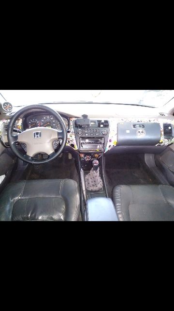

Update: fixed the center light. Was going blind from the bare light bulb so I decided to make a small cover that still illuminated the console but didn't give me eye cancer. I decided to go all out and spend a whole 0 dollars and ended up cutting a screw on screwdriver cap in half and permatexing it on. Color matches the console and looks pretty good. Also got a new autometer oil pressure gauge since my last one exploded and spit oil on my dash. I was losing almost a quart a trip through that gauge. Also got a cheap Bosch temperature gauge which gets replace very soon since it got stuck on day 1 before I even installed it .

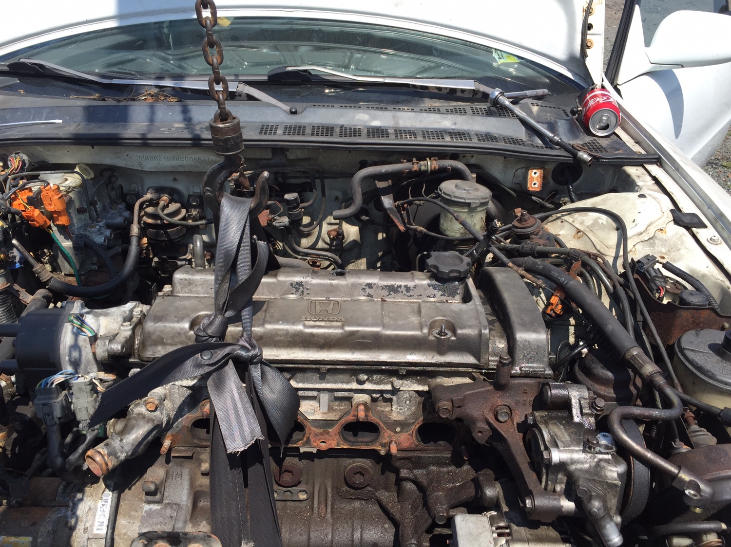

Frankensteins motor officially went. Missed 4th and hit 2nd at about 100. Car showed no signs of any damage until about a month later. Managed to get lucky at the junkyard and find the ONLY prelude si they had. Got an h23a with trans (non vtec). I was cleaning off the motor at home when I realized the motor had a jasper engine sticker. Turns out the motor was a re manufactured motor made in 09. I knew something was up because of how clean the valves and head were. Looks like I got a brand new motor that was barely broken in and a good transmission for 400 out the door. I'll post pics of the swap after I find a garage to do it in lol. .

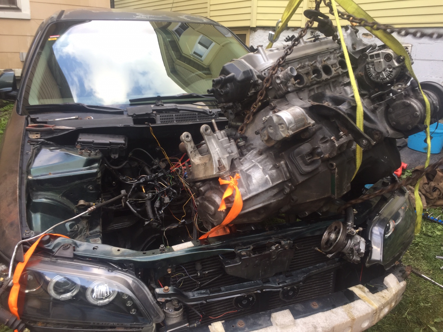

H23 is officially in. Missing a few critical pieces but the initial startup should be rather soon. Motor was put in with a hoist, in the rain up a hill of mud and grass. Needless to say it was well worth it. I was fortunate enough to find just about every part on the prelude I took this motor out of including the resistor box. Wiring was straightforward but I'm good at wiring so this was never an issue. For the most part the wires are well hidden but this is far from a photo shoot tuck. Just wanted an engine bay with a motor and trans.

Update: Started on the wiring and realized it would be easier to re-wire the entire engine bay. This means pulling every wire back through the firewall, making new harness wraps and individually sending each harness out into the engine bay. This provides a clean ďwire freeĒ look and generally makes things easier to work on as you have access to each individual wire and the full length of it.
I also received my Ecu and obd1 jumper harness. The entire jumper had to be repinned so the f23 harness would correspond with all the h23 Ecu pins. The fuse box was also relocated inside the cabin to make yet even more available space. I will post more pictures with the wiring is more complete. Yes I used a lint roller because I was too lazy to buy masking tape lol
