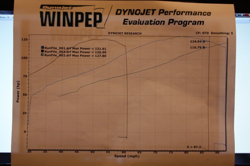

your vtec isn't providing you with enough power that you should be wasting your time worrying about it
here's a stock dyno, you tell me where the vtec is making the difference in the linear powerband and i'll tell you how much energy you should put into fixing it
