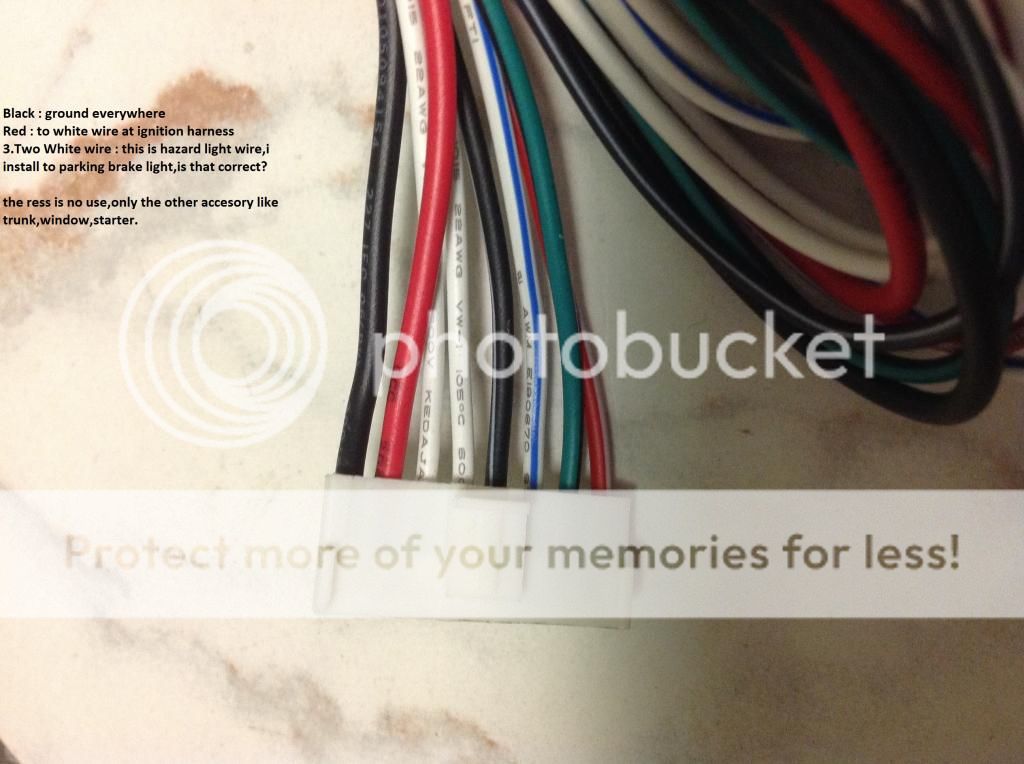

i try to understand for DIY car alarm from this forum.
but i really dont understand for the relay.
i waste my whole day for this,but nothing.. :bash:
here are my alarm system and wire.
see the number in the picture,thats i need help from 6thgen-ers..
i appreciate your help boss..

I mentioned this in the PM you send me...
I would strongly suggest you not tackle this on your own if you have not worked with wiring or installed an alarm before. Saving some $$ and possibly causing a fire is not worth it.

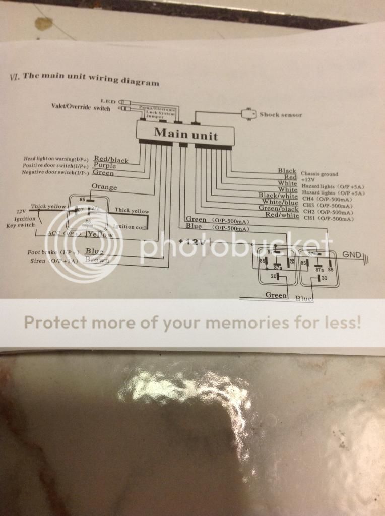

With that said...from your diagram it seems the one relay you DO have is for the ignition connections. The other 2 relays pictured could be for other "option" functions and not standard with everymodel(ie. rear defogger etc)

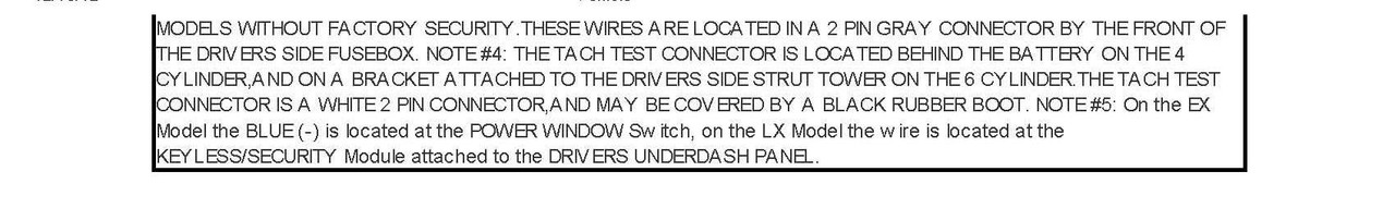

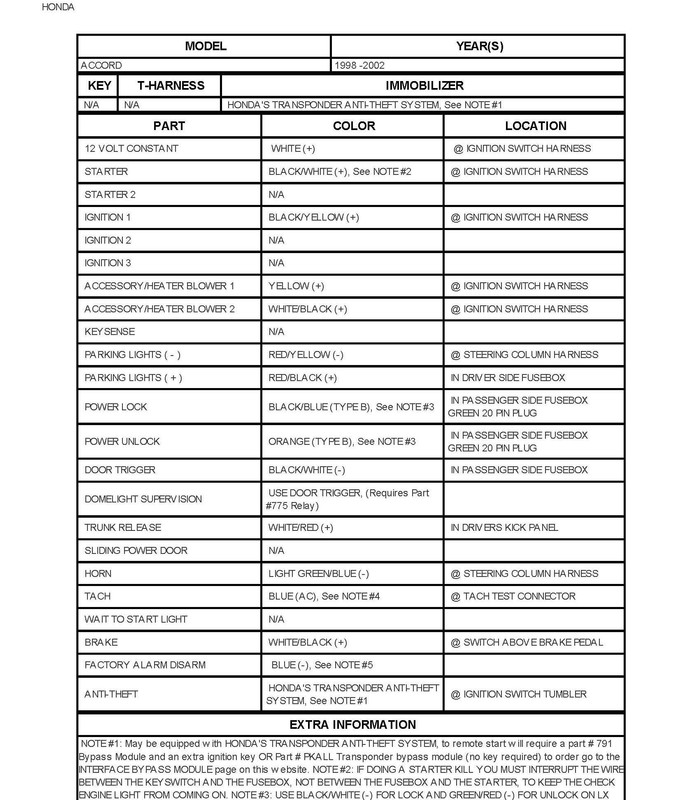

If you still want to do this alone this will help you with where to find the wiring on the car...

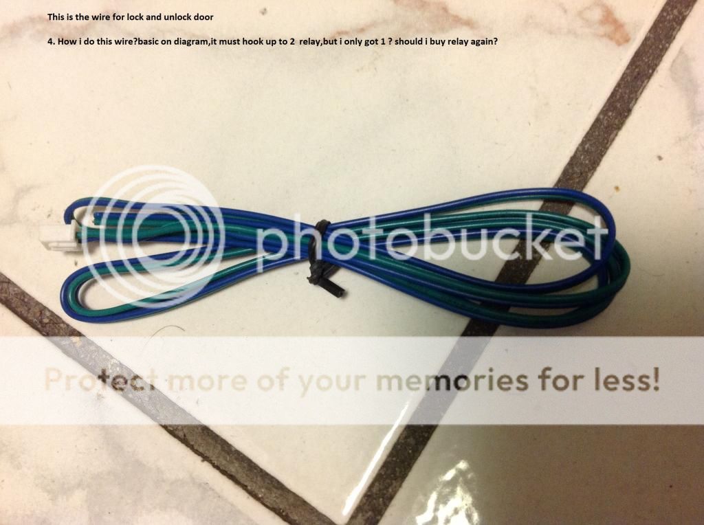

thanks..but i like to do by myself..
so,how i do with this relay?i mean what wire should i connect to this relay?cause i just for alarm and trunk only..
if the trunk can't,then ok..

What alarm system is this?
Is it an alarm or a car starter as well?

From the diagram you posted I have no idea what those green and blue wires are for .
I have not bothered installing any of my car alarms simply for the reason as its pretty easy to cut/snip the wrong wire with hundreds of wires under the dash. If you want to do it...LOOK AT the diagram I posted above. It shows where the wires you need are located in YOUR car and their colors. Read through whatever manual you got with your cheap alarm and use some tape to label all the wires(where they connect/what color wire). I would strongly suggest on soldering all your connections...if not then at least make sure everything is tightly together and use heat shrink tubing. Disconnect the battery to avoid any issues if you accidentally short circuit something.
For an alarm only i believe you should only need to tap two of the wires to the ignition constant power and you shouldn't need a relay for them(at least my old 1way alarm had none), and the rest is just tapping into door locks, door open sensors, dome light, parking lights, installing hood level switch, trunk opener(Not on LX). Rear defrost I believe needs a relay but that option is usually only on alarm/starter combos only.
Someone else who has gone through installing their own alarm in their car with success can chime in for more info...
cheap alarm..for learning :henry:
http://www.ebay.com/itm/CAR-ALARM-C...iter_Display:2.3L&hash=item2576693c66&vxp=mtr
ok,so i the green and blue wire i have to connect it directly,withouth relay.is that right?

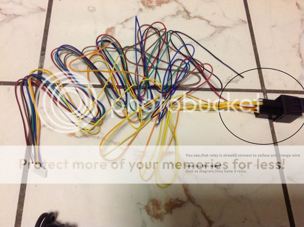

i try to understand,my relay is SPDT relay when the coil not energized
just confused where to connect the number
85 as yellow wire should be go to 12v constant or ignition?
87a as big yellow wire ?
30 as a big yellow wire ?

Since you are determined, here is some required reading: Relays explained

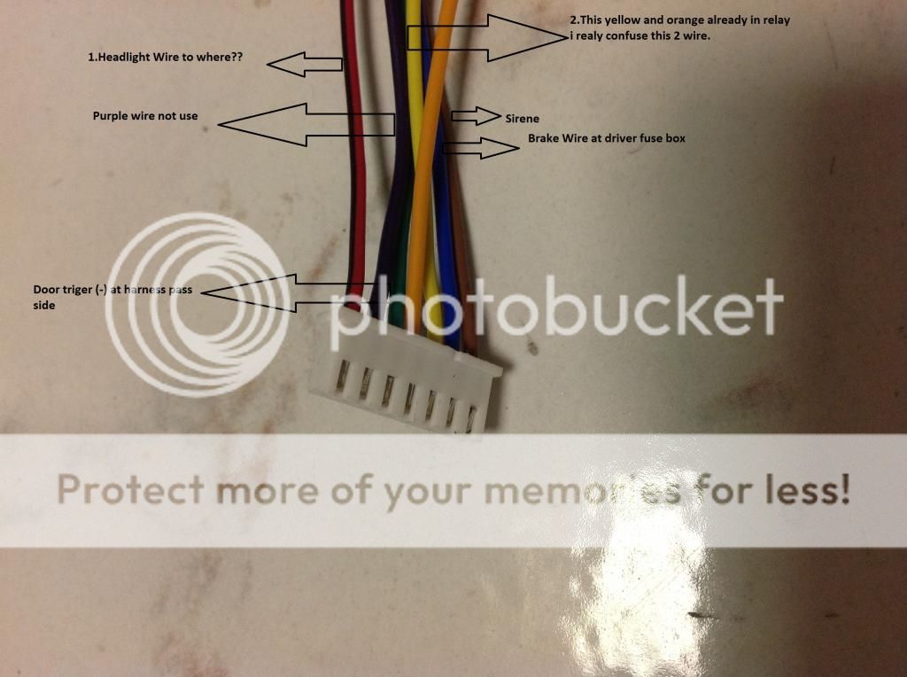

im done today!!but only
1.hazard wire location
2.headlight wire locatin
anyone can tell me with pictures for hazard and headlights wire locatin?
