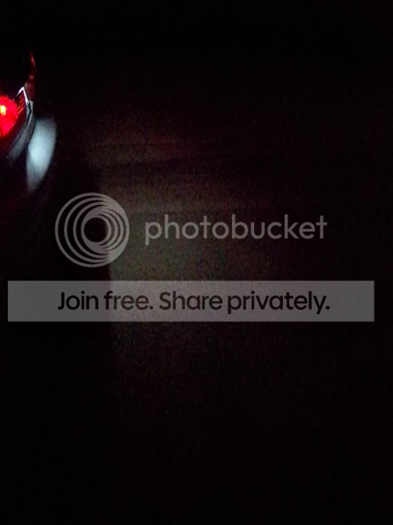

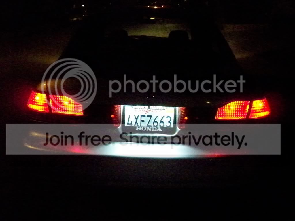

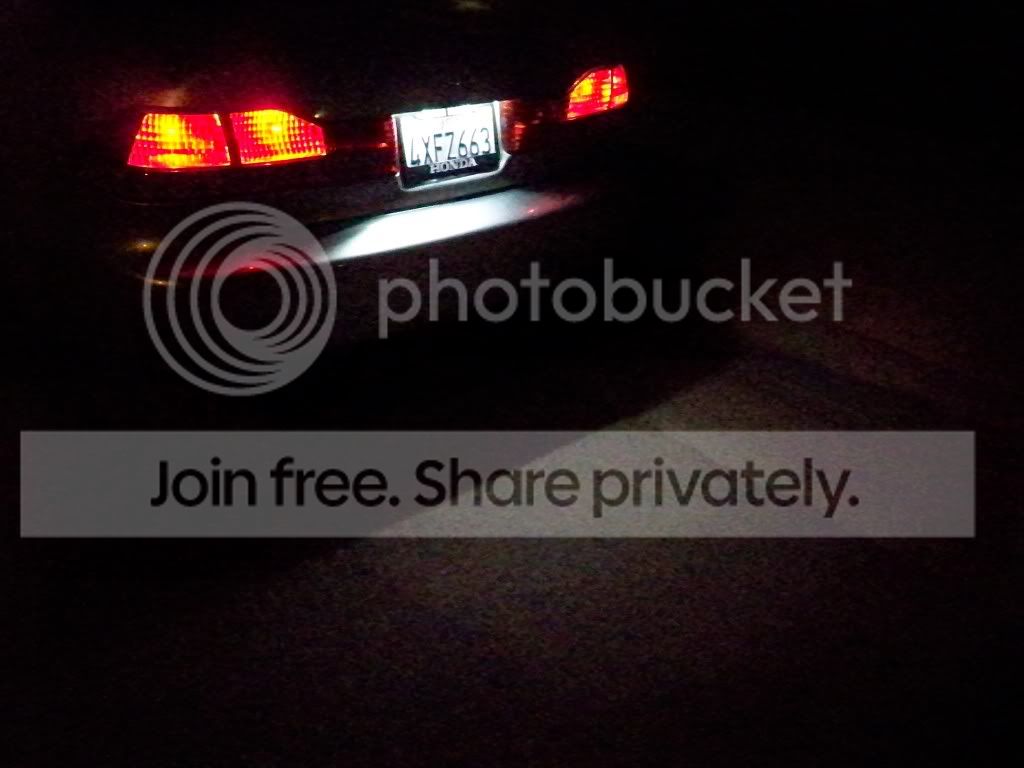

So bright that they light up the streets! (much brighter than pictures..)
vorin
Feb 25, 2009
227
Nashville, TN
Re: DIY Cathode Lighting: License Plate, Dome Lamp, Trunk lighting... **56k=certain d
i know what you mean (about lighting up the street.)
one time, i was left my car running outside my appt. while i ran in to get something, and when i came back out, i approached the car from the side and saw the white behind the car and thought if there was any way that my car was in reverse.:ohyou:

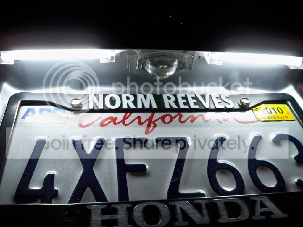

No more teasers... Been working on cathode kits for license plates. I had a few goals:
-Completely plug and play. No splicing, electrical tape or any of that stuff. Just insert, adhere, and go.
-Integrated diodes. These serve two purposes. One, they prevent current from flowing backwards through the cathode's inverter, which would break it. Secondly, they lower the voltage slightly, providing a voltage closer or slightly lower then 12 volts.
-Built in fuse. God forbid you encounter a short somewhere, this would be a nice safety measure to have.
-Full sleeving and clean appearance. It makes the kit much easier to install and remove, very organized.
These took allot longer to make then I had imagined! My goal with selling them is just to break even. If there is still demand after that, I will make some more. Some pictures of the completed kits...
Currently stocking white, blue and green.
Inline 3a fuse. ATO type, for simple and easy replacement if needed.
Wiring harness plugs directly into the stock bulb socket. Here is a shot of teh harness and the stock 194 bulb.
Diodes (as seen in the picture) are soldered and hot glued into the bulb connector, for a strong connection and clean appearance.
Carbon fiber pattern sleeving. Looks dark grey from most distances and angles.
All sleeving and wired connection heatshrinked, and not burnt!
