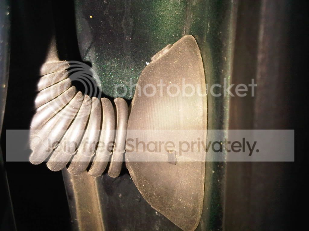

step 3: Pop off the grommet from both sides...body side you need a flat-head door side you can just squeeze and pull out or push out from inside door
step 4: feed your speaker wire thru the loom, easier to start from the bottom and push it up because its easier to work it thru the accordion in the beginning...

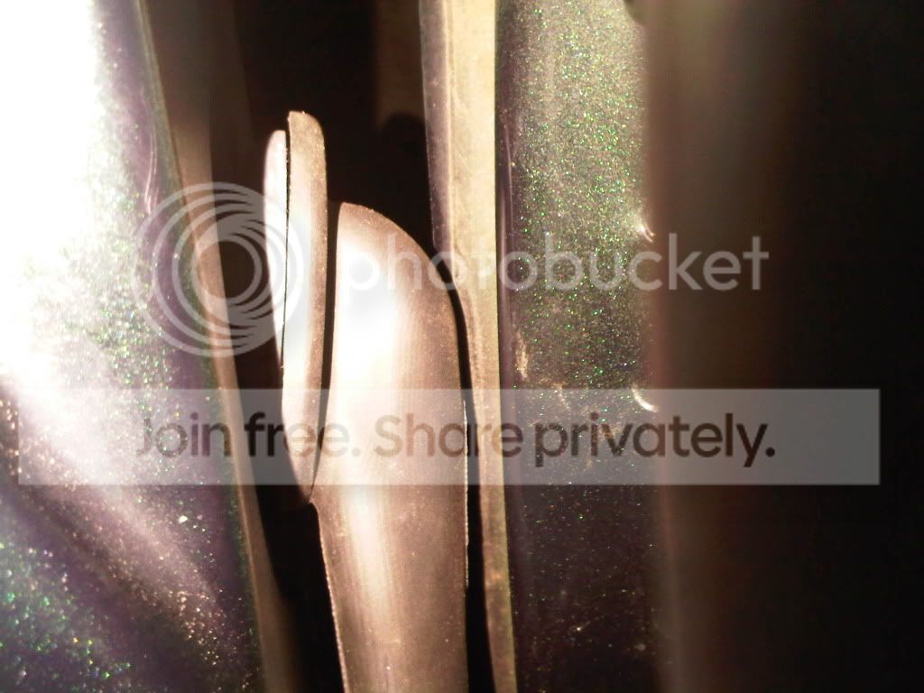

step 5: feed the bottom part into the door and squeeze rubber back into place...pretty straight forward since you can reach thru the inside of the door and pull wire
step 5: pretty easy too IF you have tiny hands...

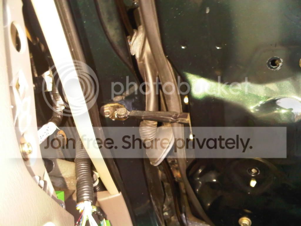

remove the cover for the fuse box on that side you will see where the harness that goes into the door connects into...push the wire in from the outside and slide your hand into the space and pull it out..push rubber back in this rubber is a bit tight might need flathead to push it in...
tips: I used rockford fosgate 12awg wire from ebay came precut in 15' rolls its the thick wire can hold its shape pushing it thru the rubber loom and such
so i didnt need to put a coat hanger or anything in there to help it thru, the wire inside the rubber grommet thing is EXPOSED its not inside of a wire loom like it appears to be so putting a coat hanger in there can cause damage...
