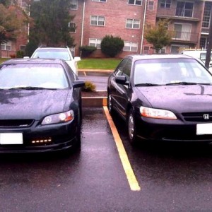

Right after I painted it satin black...but hadn't lowered it yet. I loved the satin black. It looked great once the car was dropped 2 - 3"
