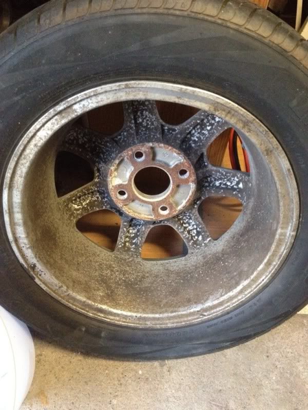

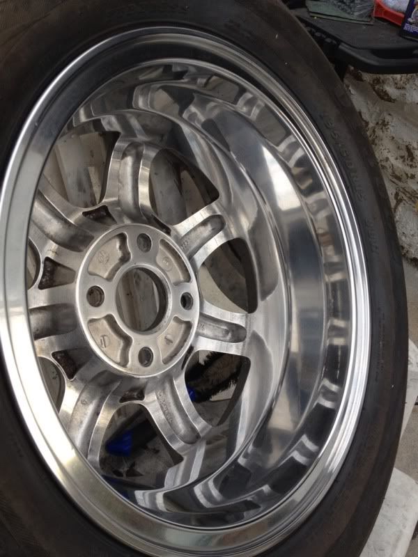

I used a drill with an attachment and also a polisher. I couldn't imagine how much more exhausting that would be if doing it by hand. Sanding the wheel grit by grit is tiresome enough. I wouldn't polish another wheel ever again, just too much work, even though the wheel looks great.
I even did the back :eek:. Can you tell I have a little ocd? lol
Before
After
Before
After
Damn! Even the back lol. I wouldn't even want to attempt that lol.
