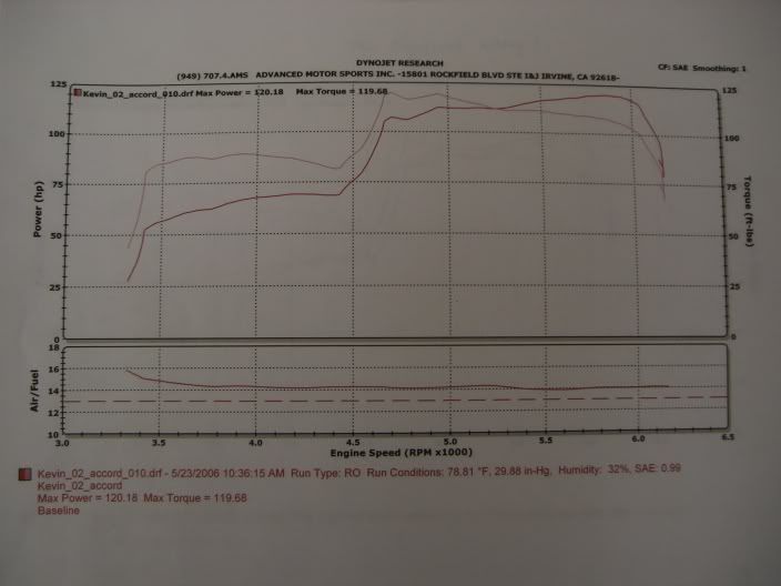

Here is the dyno for the previous bolt on mods.
120whp, 119wtq

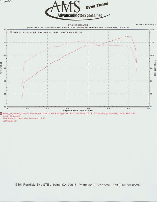

here is the dyno with all the mods adding together
129whp,122wtq
the numbers for before tuning suppose to be a little lower because the dyno read the spike. the dyno is a mustang dyno which supposely reads lower than like dynojets.
tuning got 6 more whp but i got less tq. but i think the guy wanted to get more area underneath the curve for more useable power.
i am kind of disappointed when i got my car back from the dyno. cause it had lost that "kick" feeling when vtec kicked in. but with the new tune, vtec engages at a lower rpm (3600 rpm) compared to the old tune (4500 rpm). also, with all those new stuff i only really gained 10whp which kind of disappointed me too. i was aiming for at least 135whp...maybe wishful thinking? :( the tune guy also said that my numbers are a tad low since the motor got heat soaked at the last runs.
i was wondering if aem pulleys and the different tires profile sizes would affect my numbers greatly or not? 205/40/16 are small as heck but would they affect the dyno numbers? if so, then i should get more whp then right? and i took out the aem pulleys cause the shop had to switch out my alternator and they forgot to put the aem ones back on and i didn't have time to put it back in. i figured they might help but i don't know how much. figured probably at most 1-3whp.
at least now my A/F ratio is nice and even, cause before my A/F ratio was all over the place and now it's a bit more even. i was running really rich at idle and then really lean at the high end.
i feel the car has more low end and easier to pick up speed...and when i put in the tb and IM (i did these last), my car actually got quieter...i don't know why but it did; even my friend said so. but like i stated above...i miss the feeling of vtec giving my the kick...i might switch the vtec engangment point higher up to see what happens later.

thanks for picking up where I left off and those numbers arent bad at all, I got like 120 on a hub dyno. 130 on a mustang dyno should be like 135-140 on a dynojet, which is like 160-170 bhp. thats not bad at all
but to get in the 150+ whp territor you can add all the mods you want but the fact that you have an auto you wont get the same whp gains as you would with a manual.
you still have the stock cat, thats impeding all the flow you gained with your head boring, the dc header doesent add anything (that ive felt at least), and a vafc tune is very limited, cant tune timing etc, and you dont need that cam gear cause its useless with a stock cam.
Also with NA setups, from what ive learned, it all comes down to big cams, bumped up compression, good header, and good tune.
If I could do it again, this is the setup id go if I wanted serious power.
manual swap
bolt ons
test pipe
bored head
cam regrind
obd1 conversion and chipped
and aem pullies dont add sh*t, stock accesory pullies weigh next to nothing stock, they cant get much lighter. Crank pulley, now thats a different story.
forget the engine man, the tranny will always be your achillies. switch that out then youll be in business.
