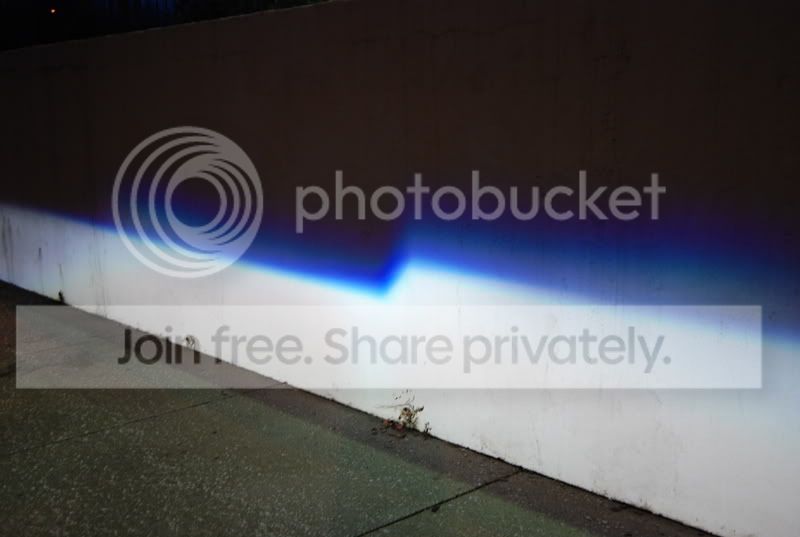

^^Well in the case of FX projectors it is really hard to get color out of the projectors unless you mod them by cutting one of the shields and then bending the other towards the bulbs..this is probably pretty hard and not to mention no turning back..
As you can see the 300zx is just an easy drop and go mod...it produces much more color then OEM since the lense is very clear and it keeps the cutoff sharp..i put the pictures above showing the difference between OEM and the lense swap...all i had to do was add a small spacer (wire in our case, or some use cardboard)
This is FX with stock lense modded..you can see that 300zx is sharper

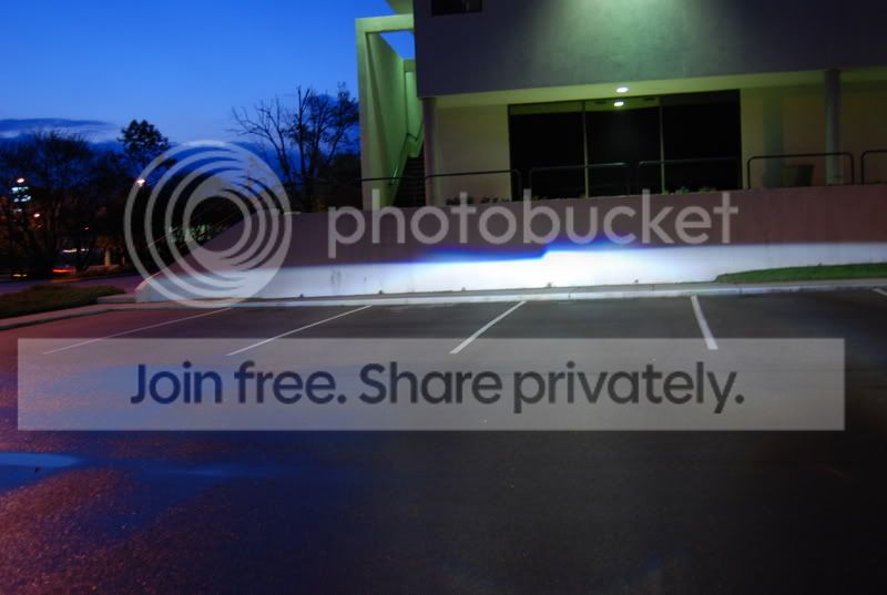

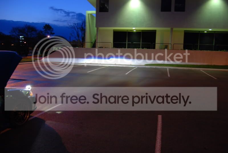

ok well went out tonight..projectors need some work..gonna have to work on the spacing but this is what i got so far :D

So you JB welded the projectors to the OEM reflectors? Which I'm assuming still gives you adjustment VIA the OEM screws? What about centering and what not, did you use a laser or anything?
00Accord4cyl
The Orange Skittle
Mar 1, 2006
7,589
15
Nashville, TN
no they have not been jb welded yet..going to do that once i get the shrouds in, they aren't actually in the housing yet...but yes i will still be able to adjust them..have not gotten centered either...going to put them on the car this weekend...get it aligned good then seal everything up..the above pictures are just of the projector sitting on the car...that is not both of them
