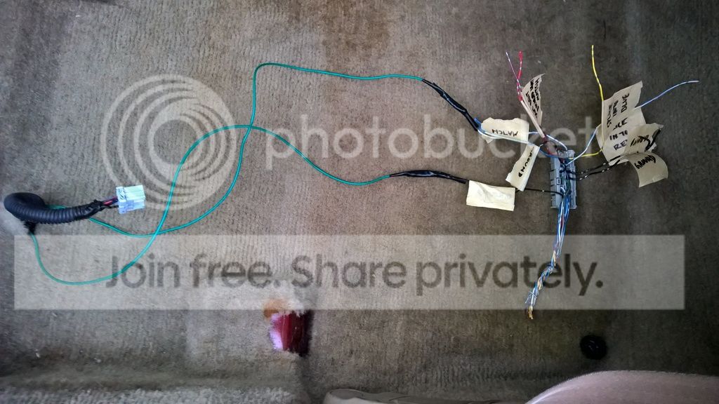

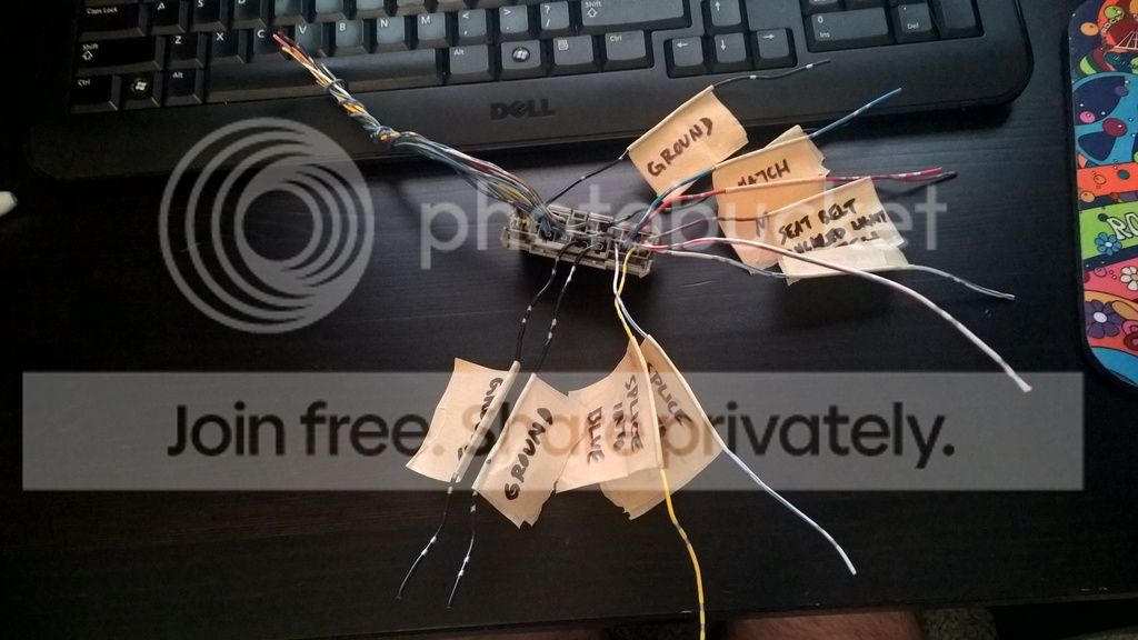

With summer drawing to a close I'm reminded of how much I hate the cold so tonight I finally revisited the CL-S seats. After rereading everything Frankie (FNCONE) told me lol I labeled all the wires and made a list of what I need to buy (grounding terminals, 7.5a inline fuses, wiring, heatshrink, etc) to get them up and running. My goal is to have at least the driver side wired up, and passenger if I can.
When I lifted the floor carpet, the passenger side only has a grounding wire/point and nothing else. Frankie told me his car ('01 V6 sedan) has some more wiring on the passenger side, which I assume must be for the side airbags or something. So I'll have to splice into everything on the driver side, then run it to the passenger side.
The perf leather panels are still in progress, I am dropping off the fronts to be done professionally, and I'll do the other rear. Then I can take the doors apart and swap the panels and switch trim, and add the CL Bose 6.5's and chrome window trim.

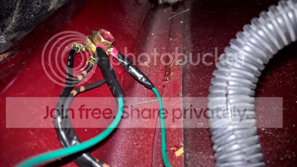

Wired up the grounds for the driver side, used all crimp connectors. The tape is just extra to seal the connections. The remaining grounds will be depinned from the Accord plug and pinned into the CL pigtail.
Forgot to get the terminals for the inline fuses, so going back to Ace to get those after work.

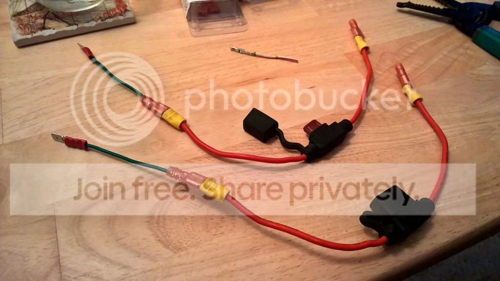

Got the inline fuses ready to go, going to make sure it all works first then go back and put tape over the connections. These will run from the CL pigtail and get spliced into the Accord harness. Between this and the DIY harness FNCONE sent me that runs from the fusebox -> switches -> seats, things are basically ready to be plugged in. I'm excited.
