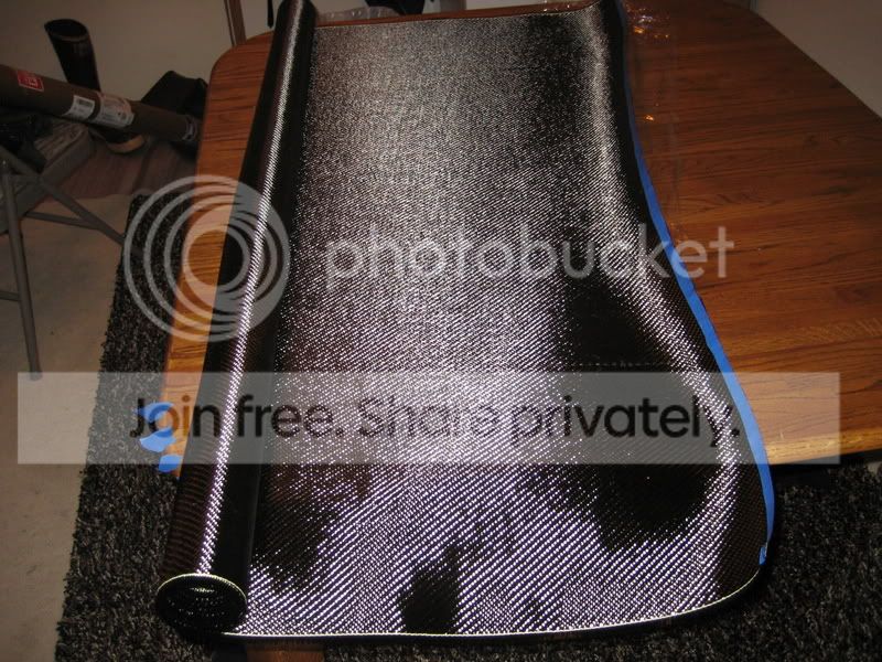

Figure out how much carbon fabric you need for the peice you are re-working.
Make shure you clean whatever surface youll have the carbon fabric on and be careful not to distort the weave.
mask the lines you will be cutting with painters tape and cut the fabric right in the middle of the tape. the tape ensures that the weave doesn't distort and make a mess of itself when cut. It also reduces allot of the waste.
make shure you clean whatever surface youll have the carbon fabric on and be careful not to distort the weave
