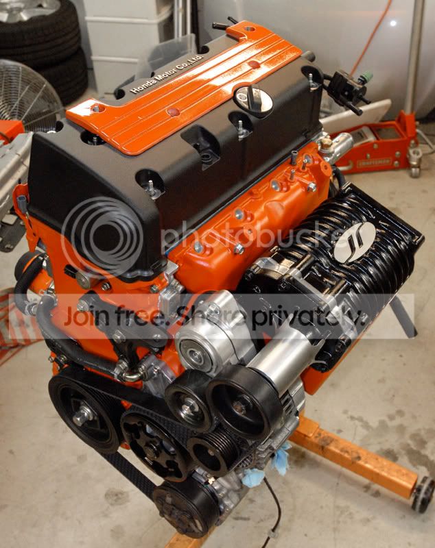

Here is some eye candy of another k20/k24 frank setup Supercharged.
