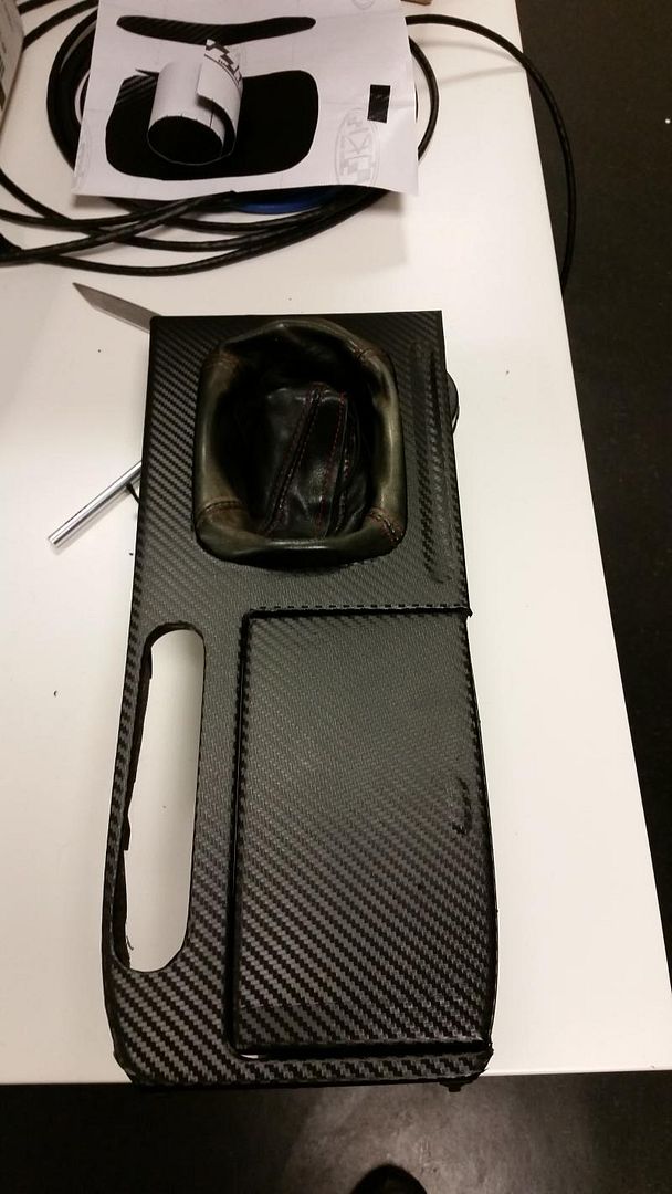

wrapped my centre console a few weeks ago. I now just need to do my heated seat bezel, but I have a feeling the angles and curves will make it difficult. Anyone have any experience?
Cut out more than you need, and stick it to the flat surface first. Then get a hairdryer or heat gun and heat the vinyl where you're gonna put it around curves. Then stretch and pull it down, like putting plastic wrap around a plate of food.
I did a computer mouse like that.

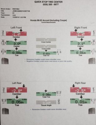

Went to go get an alignment today after installing the coils and dropping it last Saturday.
Sitting at 24.5 F and 24.75 R, moderate drop but rather get it done now so I don't eat up my tires too quick I probably won't get another chance till next year but it'll do for now.
Here are the alignment specs, toe seems to be pretty close to zero so I should be good.

That is freaking awesome! Thanks for the tips!
