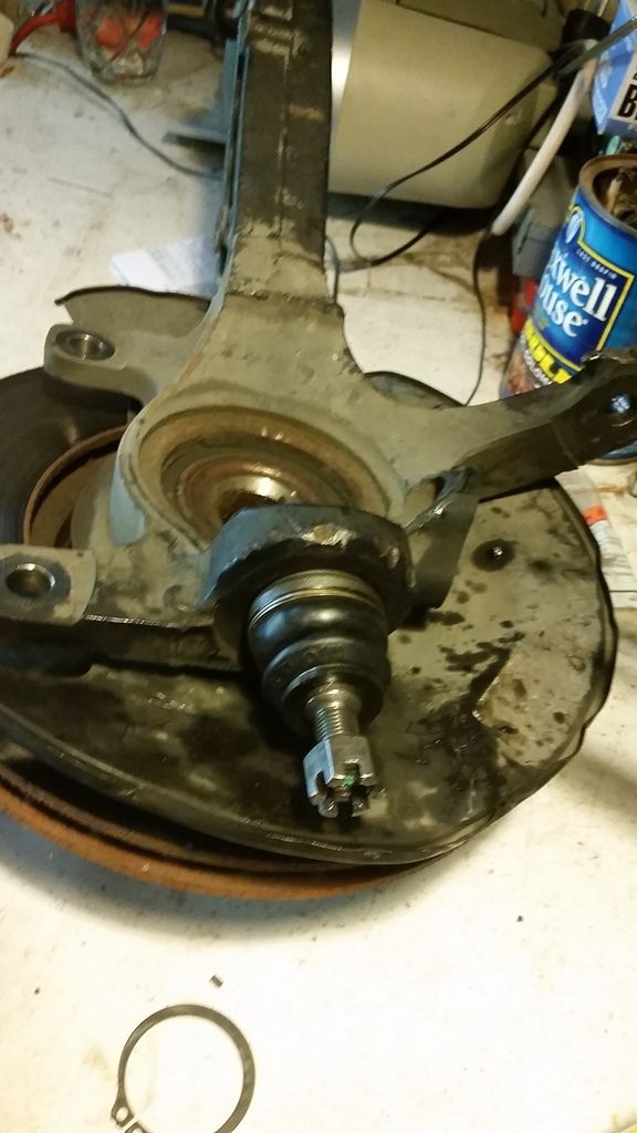

I then took the front knuckle over to the work bench and checked for a snap ring which there was not, so I proceeded to let my sludge hammer and ball joint talk out their differences till they parted ways.
Sorry old O.E. ball joint but this is where your love story with the lower control arm ends.
So the new relationship with lower control arm begins with the Problem Solver ball joint from Moog, I have had great luck with these in the past so I always stick with what has good success with daily abuse.

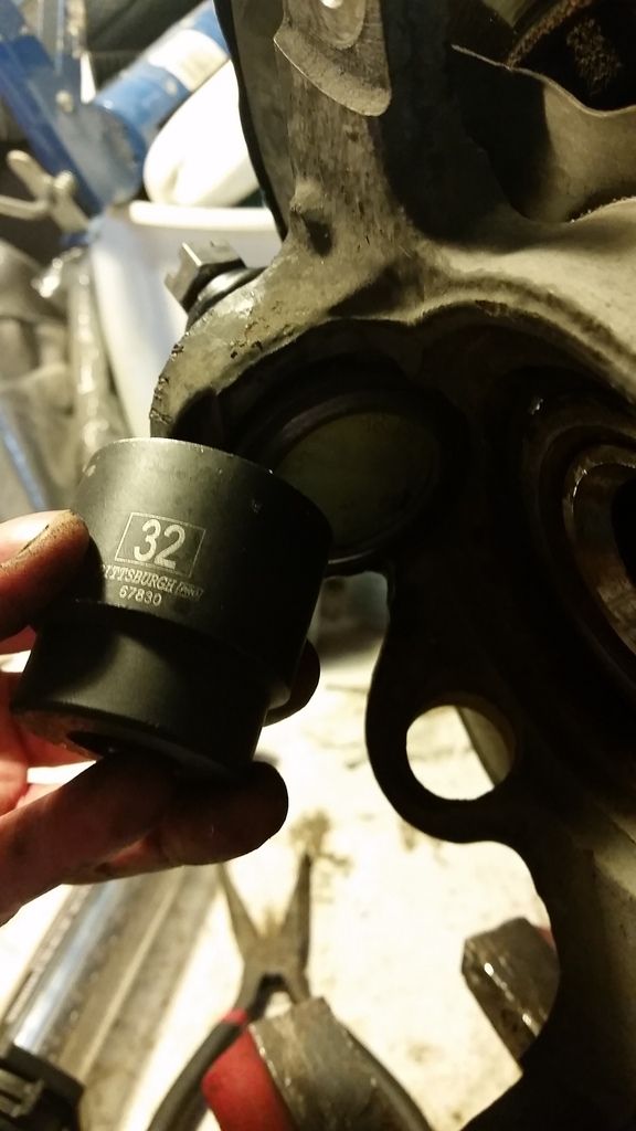

Now here is where I am going to give some of you guys out there a good tip who don't have enough money to rent or afford to buy a proper ball joint press kit.
As many of you know, those kits can be pricey and over half the time you fight the kit trying to make it fit and I'm too old and crotchety for dealing with that crap anymore
My solution, grab a 32mm forged socket and mate it flat on the outer race of the ball joint and with the knuckle firmly in the vice you can start hammering it in nice and slow for a even but true result of driving it home properly.
You too good for your home ball joint? Naaahhh your cool look at you resting in there all peacefully now lol.
Then after reassuring everything was good to go the snap ring was installed and brought back to it's proper resting place in the wheel well.
