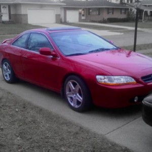

So...I'm finally venturing into the lowered car world. Puzzlemaster(Evan) was gracious enough to allow me to be the first buyer of his Tein SS coilovers.
In short, I'd like to know thoughts and opinions on what old components I should replace while I'm doing this. I've already got new shock bolts/nuts, the pinch bolts for the front forks, and new Moog sway bar links for the rear.
Should I replace the front sway bar links while I'm at it?
Only reason I'm replacing the rears is because they're seized and I'm going to have to cut them off to remove the strut.
Not messing with tie rods or anything like that as everything else looks to be in pretty good shape. Alignment will be done but probably wont be too far off.
Luckily, I have the GF's car as a back-up because my DD has become my temporary project, lol. We got the LF corner swapped but broke the pinch bolt in the process; RF swapped over easy. As we moved to the rears we got the top and bottom shock bolts loose but couldn't get the strut assembly off the car. Mind you we weren't using spring compressors but a buddy of mine seems to think that'd do the trick and would save me from having to cut off the old links. While he may be right, as rusted and seized as stuff has been, I think its a good idea to replace them nonetheless. So as she sits, the front is lowered and the rear is still stock height. Sadly, its a barely noticeable difference, lol.
So, any other thoughts or opinions on what I should replace or watch out for would be appreciated. I don't think I'm forgetting anything but I might, lol.
