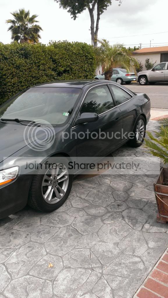

just put on 225/55/17's on my car. Love how they fill the wheel gap and there pretty comfy. Pretty sure my speedo is off now though. Don't know the offset, had to use wheel spacers, and roll my fenders and tucked in the plastic cover where the fenders were rolled
