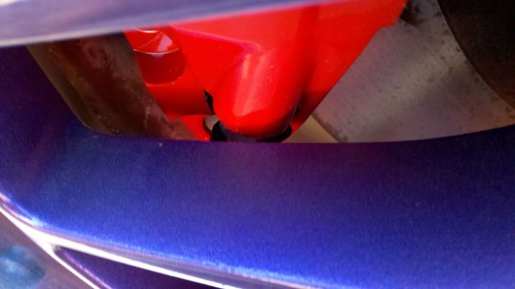

So...test-fitted the VS's over the BBK today finally...and they clear! I cannot believe it, really thought these wheels would not work out. There is about 1/8" of room between the caliper and back of the disk...so happy.
So the lips just need refinished, the disks/rivets need painted, and I want to make the rears wider by 1".
The fronts may poke just slightly until I can get some GC sleeves for the Yellows. I am going to put 225/40's on the front. Not sure what tire size to put on rear yet. Got time to think about it though, lol.
