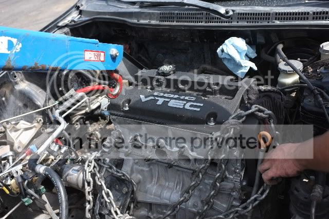

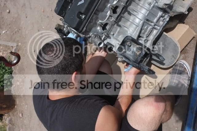

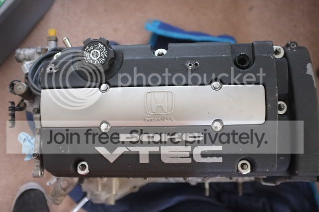

Starting swap, Here we go...
Obviously that F23a1 needs to come out, trans, wiring, all of it. Assuming you know how to remove an engine, i wont post the step by step pics i've taken, just the pics i feel are important to the swap. If you need pics, pm me.

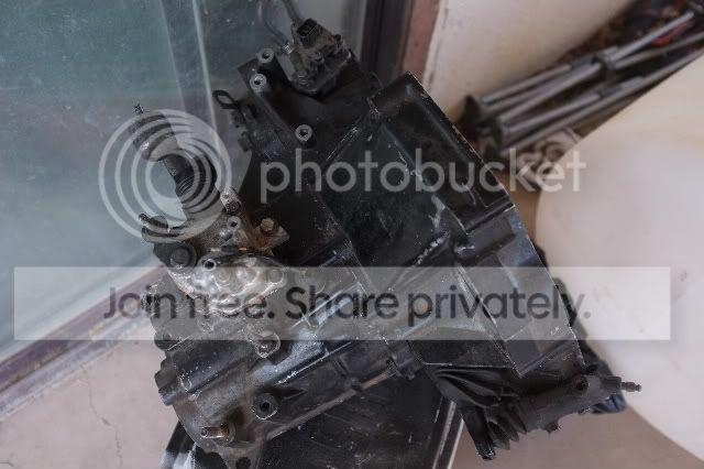

Scored a trans too, No idea what ratio's it has. =/ will figure it out and then show you a step by step on the 1-4 gear swap into the f23a1 trans.

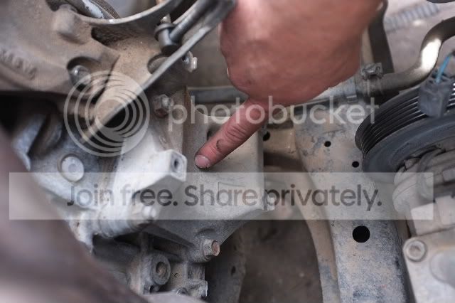

To use accord A/c compressor, Take this bracket from F23, and Transfer to H22, it's an exact fit.

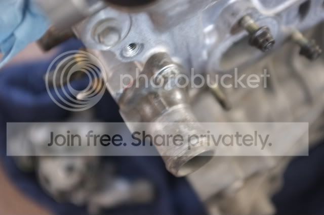

You will need the accord f23 water outlet for the h22 head so the upper radiator hose will work, H22 outlet left, and f23 on right
Day 1 progress, Since then I have the trans out, and the engine harness out. will post more pics tomorrow.

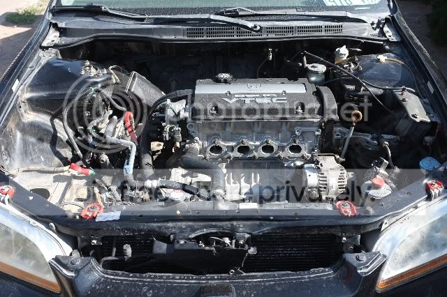

Re: 99CcordMTF23's H22-Swap thread! New pics, pg2.
Engine is in! Fit's almost like a glove, it's temporarily on the h22 mount with on bolt through it untill i get a modified mount. I transfered all my Sensors from the F23 i could onto the H22 (Ect, gauge sender, Vtec pressure switch, blah.) And i have figured out the Distributor wiring. Going to try and move all the guts from the Accord Dizzy into the H22 Dizzy and get an internal coil Cap and rotor, Should make the swap much easier for some. Haveing trouble with the IACV, Do i just wire the Pos and ground to the Prelude iacv, and not use the Signal wire from the f23 plug?
Only Problems so far, The oil pan is about 1/4 inch away from the subframe on the drivers side. =/ engine shouldn't fall out so not too worried. the prelude PS bracket wont fit with the accord alternator bracket. Will change them all out. The intake manifold didnt fit untill i removed the ITB's, which i'm not using anyway. Also i have no place for the IAT sensor. (Intake Air Temp.)
I'm going to use my accord TB for now since i want cruise and the TPS is broken on the H22 TB.
Any questions, Pm me.
Using accord clutch and flywheel.
You can see the TDC and CKP sensor plug. I don't need to extend them to the dizzy since this in an OBD2 h22a4.
Bolt trans on. lol Thing made me angry.
Took me literally Ten minutes to bolt it in...
Almost looks OEM... haha

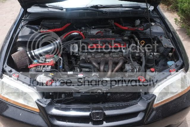

Re: 99CcordMTF23's H22-Swap thread! Update, 6/6/12, pics pg2!
Everything went together easier than when i replaced the f23 two years ago. the H22 just kinda fell into place. I am pretty sure there aren't too many modifications needed to be made to my accord harness, besides extending a couple wires and that's it. My Ecu is coming soon, as well as the Header, and my OBD1 conversion harness. Just put it's first oil and filter in today. Gonna throw synchromesh in the trans tomorrow and just button things up untill parts arrive. My goal was to Get people into the H22 swap for the accord without going "God it's such a pain in the ****" And see some more Modified swapped CG's. talking the wife into letting me slam it too!
