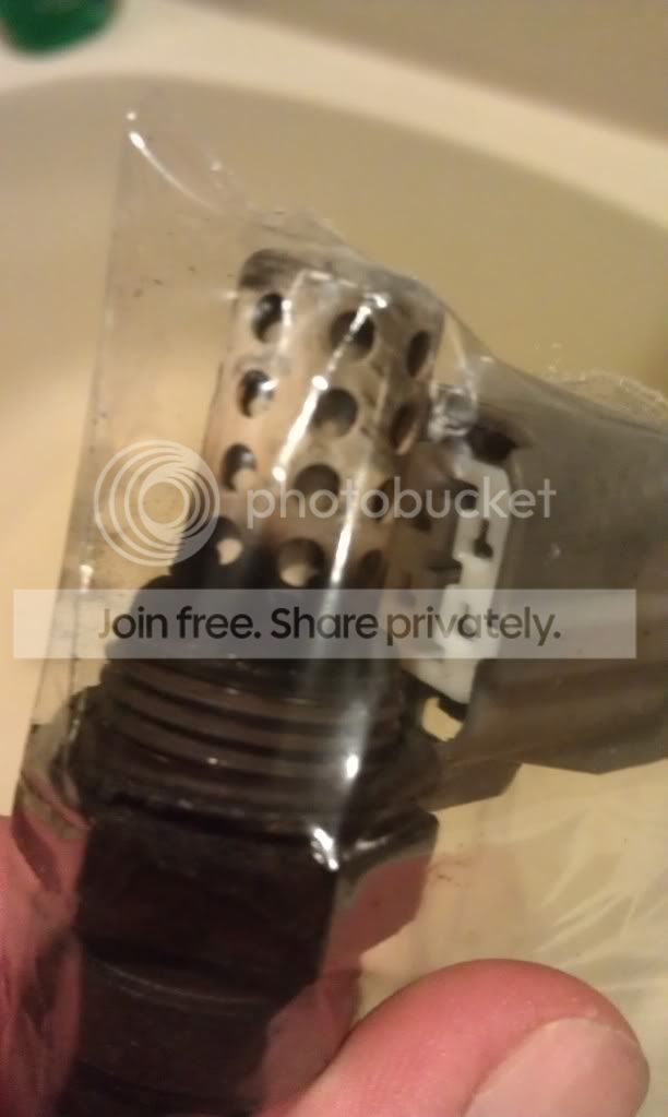

This is the O2 sensor from the Catalytic Converter

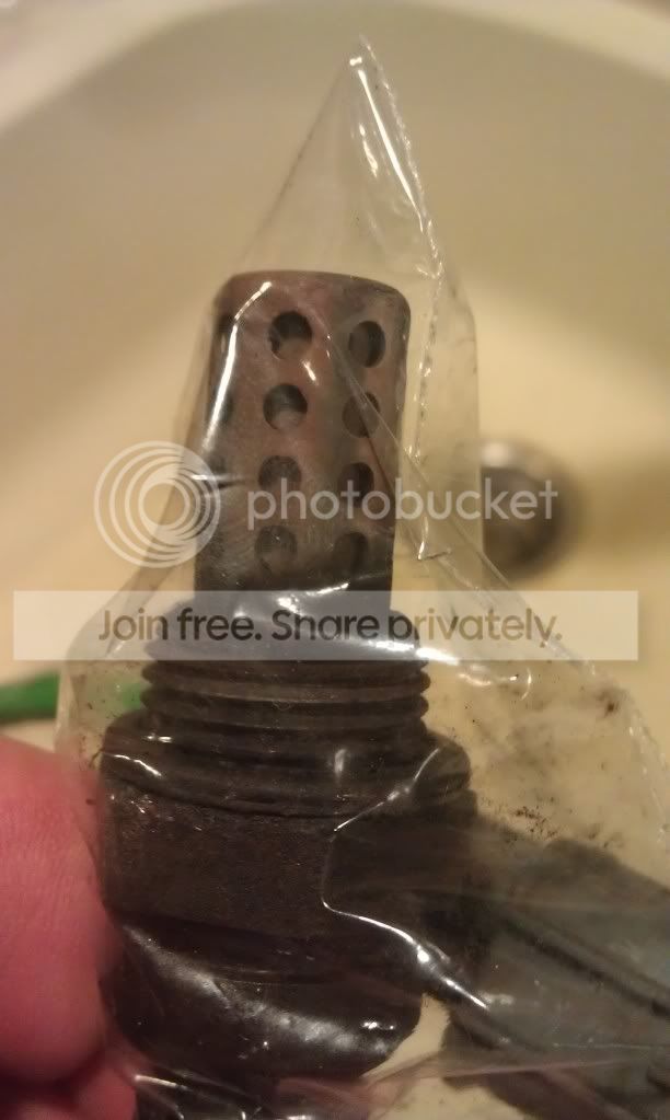

And this is the O2 sensor from the downpipe
you wont be able to tell much looking at them...you best way to test them would be to test them for the voltages they output when on the car.
