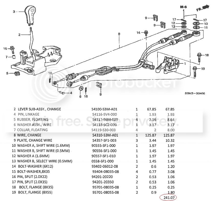

The parts used for this swap are quite simple everything is available from Honda except the harness. Try to get as many parts off the donor car as possible. Here are some diagrams of the parts needed.

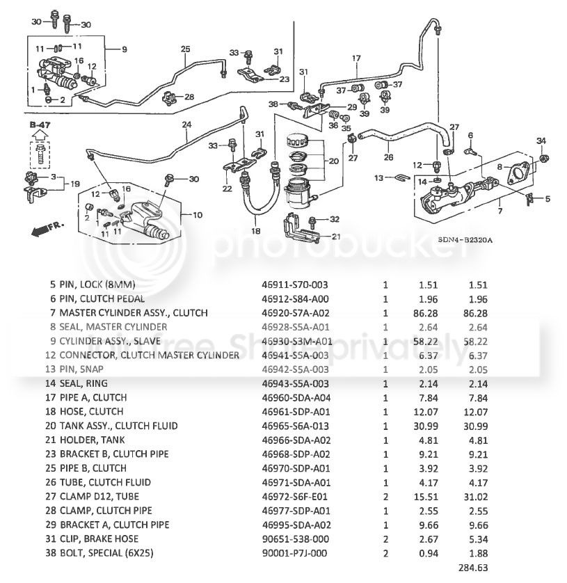

Clutch hydraulics
You can use the clutch lines from the CL-S as well as the master cylinder. I have tried using a master cylinder from a mid 90's Civic as well and it works just fine and is a good bit cheaper.
Clutch Disc, Pressure Plate and Flywheel
You can use the clutch disc, pressure plate and flywheel from any 6 speed transmission. The Accord, TL and CL all use the same clutch but the CL uses a different flywheel which doesn't matter with this harness.
Shifter and Linkages
The I4 Accord shifter and linkages are not a direct fit and will have to be modified. The only linkages and shifter that are a direct fit are the from the 03 CL-S.

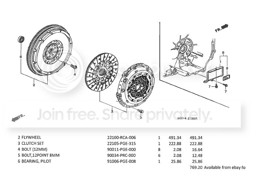

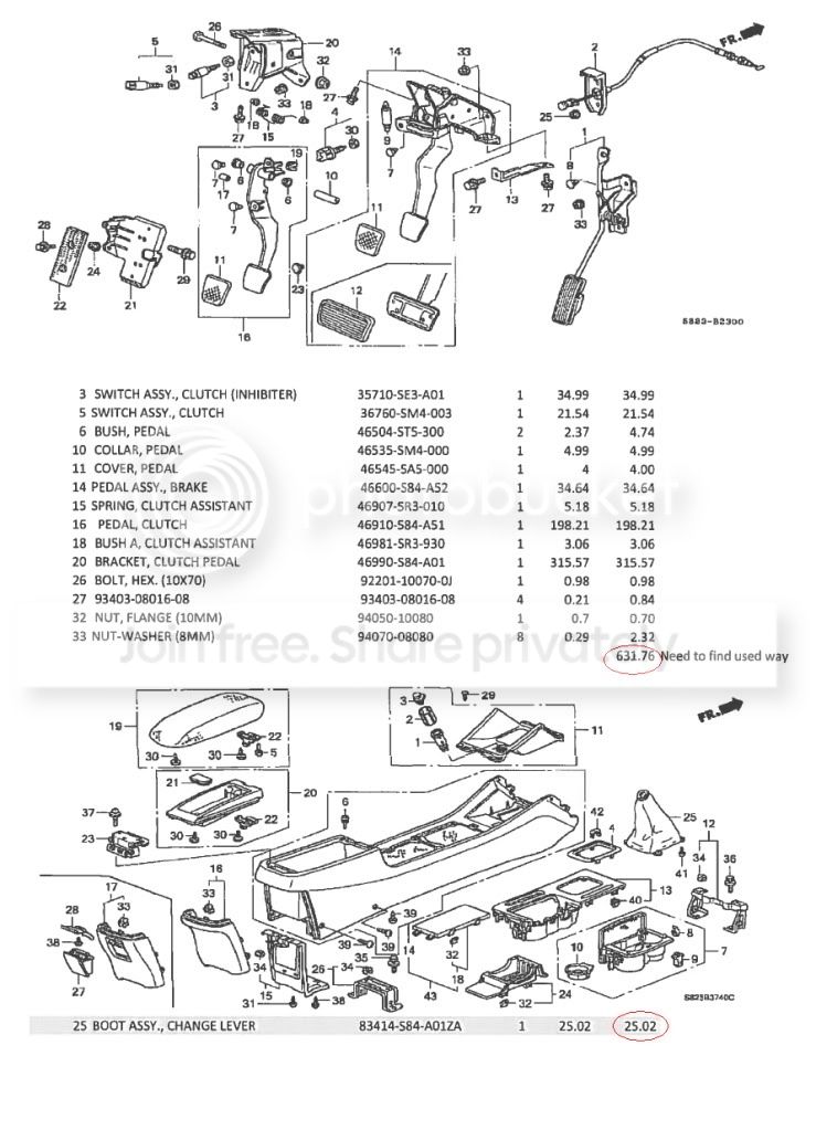

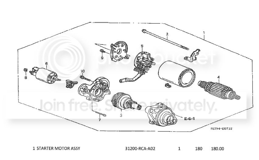

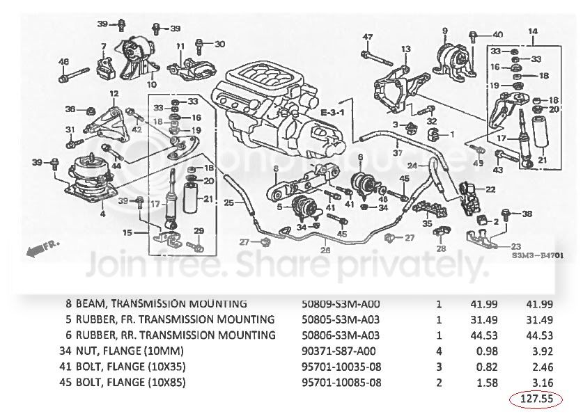

HELPFUL DIAGRAMS INCLUDING 2011-2012 PRICING
99.9% of the list is needed.

I like that you posted the parts diagrams though.
