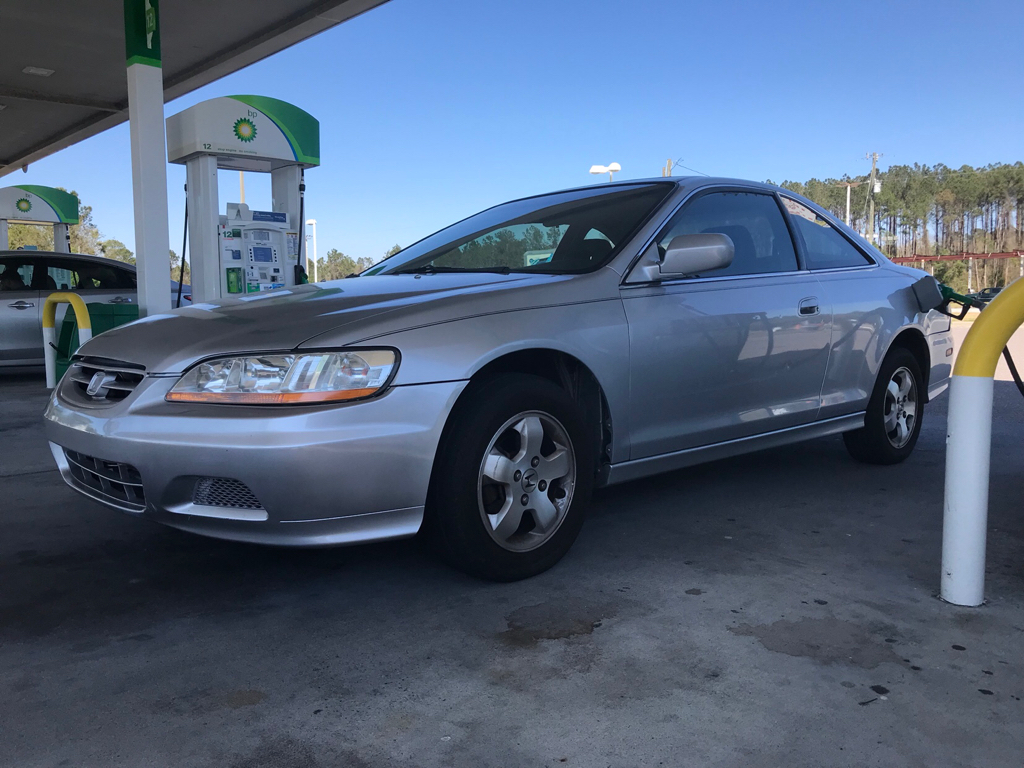

What are my options are far as a direct swap for a automatic transmission?
Just purchased the car for $600.
I do have about $2000 to spend on her and a Engine and 5 speed swap are a possibility.
