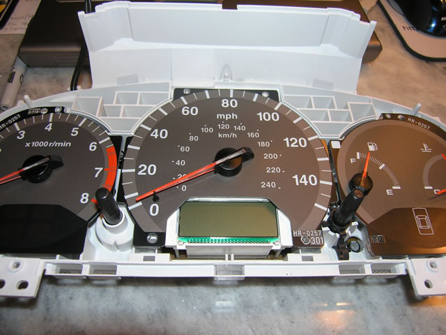

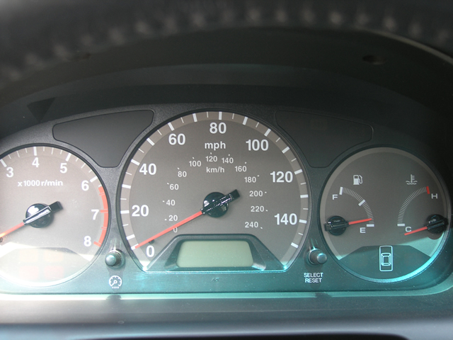

question about the gauges - it looks like you have really bad hot spotting on the needles - is it really that bad at night or is it just some weird camera setting?

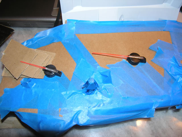

The LEDs (well, the console part) has turned into one of those "crafty" projects. I'm on what I'd call "Phase 2"......there were bad hot spots in "Phase 1" (the photo you remarked about). When I cleared out the needles, everything went south quickly!!
I didn't like how they cleared out completely in the center but not on the needles themselves. I believe there is also orange on the back of my needles.
As an interim solution, I used touch up paint for my car to paint the needle hubs.
This has cut down on any hot spots caused by the clear needles. The final phase of the console will be the replacement of all three gauge clusters (for new needles...) and Speedhut overlays to alleviate the problem I am having with even lighting across all gauges.

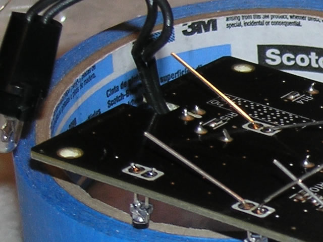

also how long did it take you to solder in all the led's, and how small were your soldering points? I'm not exactly a surgeon with a soldering iron lol
This is a closeup of three of the LEDs I soldered for the indicator LEDs on the climate control:
This is definitely a case where having the right tool helps. I used the soldering iron (64-2051, $7.99 @ RadioShack) and solder (64-035E, a couple bucks @ RadioShack) recommended by LED Automotive and had no issues. The way the contacts are on the circuit board, the solder just pools there. There aren't any circuits nearby to accidentally cross, either. I don't remember exactly how long it took but I was able to solder the LEDs for the cruise control (x2), sunroof (x2), climate control (x3), indicators (x8) over the period of a few hours.

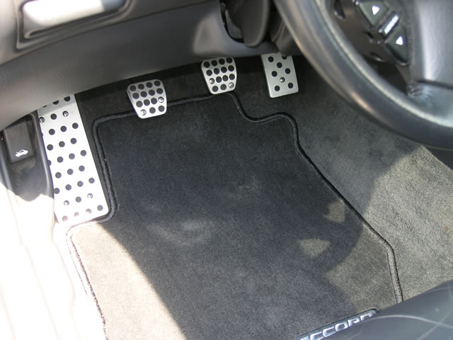

And I finally found a task I could handle the first time around......new floor mats!!...

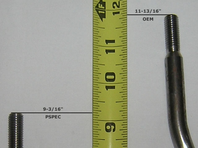

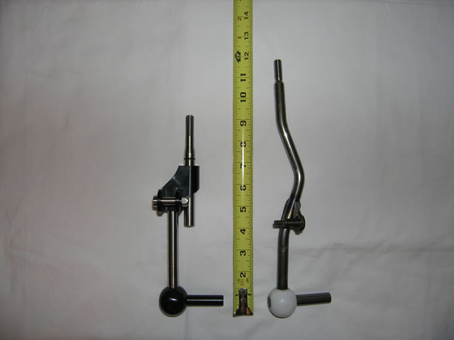

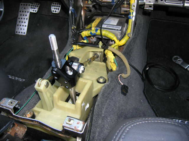

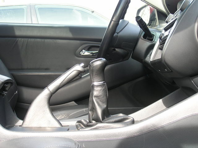

Talking PSPEC is installed!!

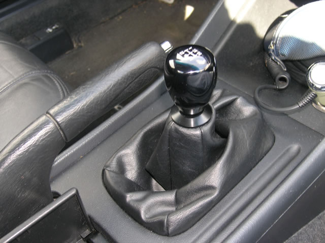

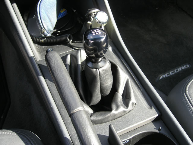

OEM shifter:
OEM side profile:
OEM to PSPEC:
PSPEC is ~2-5/8" shorter:

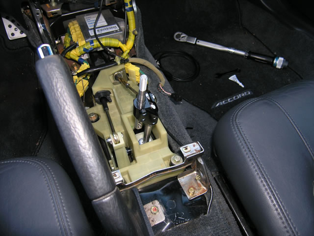

All the dashboard pieces I needed to take out during installation:

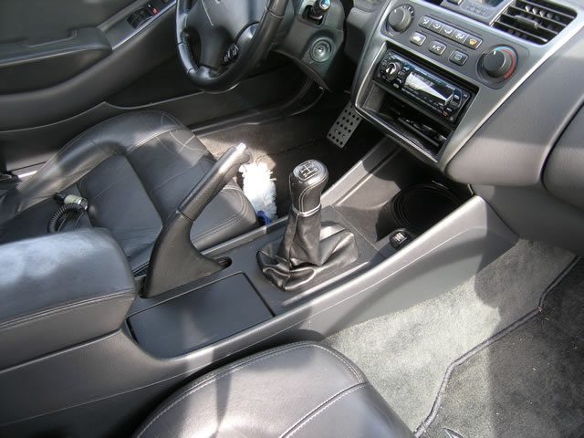

PSPEC installed in shifter frame and back in the car:
PSPEC side profile:
Remember that OEM side profile?
Installation complete:
Now, that's more like it!...
I absolutely love it!!

Where did you get the pedals, they are mint

The pedals are from www.ultimatepedals.com ...they have all kinds of options. It is recommended to get tread on the brake pedal at the very least...so I opted for the flat rubber inserts for all pedals. I also like that they offer a foot rest. It's also nice that the pedals are essential OEM in size and shape.
