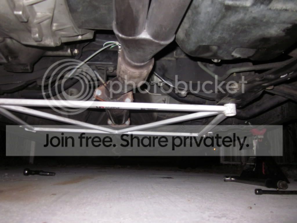

Take a look at picture #1. See that seam that juts out about 1/8 of an inch. That seam is going to prevent the brace from sitting flush. You DO NOT want to modify that seam. You would need to modify the front mounting area of the brace itself.

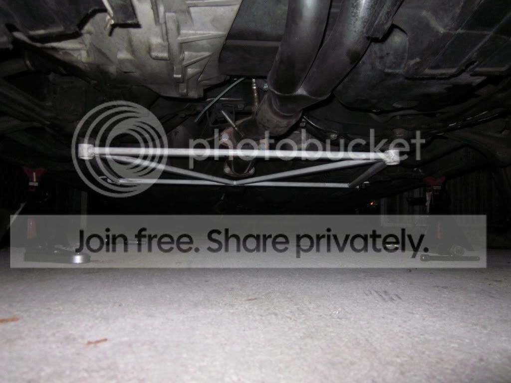

Take a look at pic #2, U/R's pic of the brace on a CF4. See the "lip" that goes over the unibody, that is the front mounting area I was talking about. It would need to be cut off.

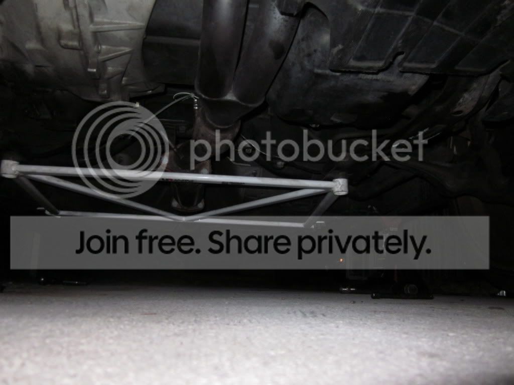

In pic #3, compare the door hinges and fender area of the unibody against pic #2. Not exactly the same, but, pretty darn close.

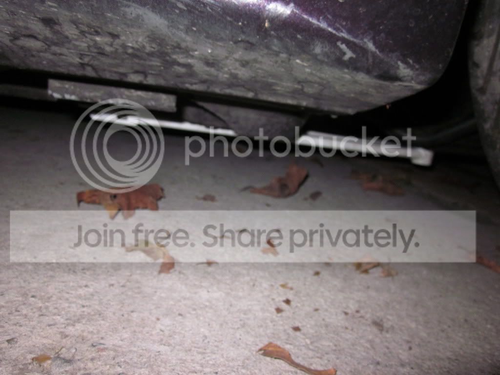

I also researched the 4 point lower REAR brace. On my car and possibly on ALL the USA Accords, the exhaust pipe seems to be a clearance issue. I have 2.5 inch exhaust and it hangs kinda low. I'm sure it could be modified to provide clearance for the brace. You would need to have the piping run really close to the "channel", or what I mean is, close to the car body.
Take a look at some pics and judge for yourself. The 1st three are from a Torneo with the 4 point brace installed. The last one is pic of a Honda-Tech member's car without the brace, again from a Torneo.
