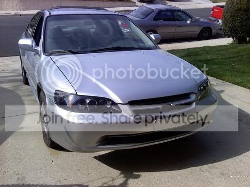

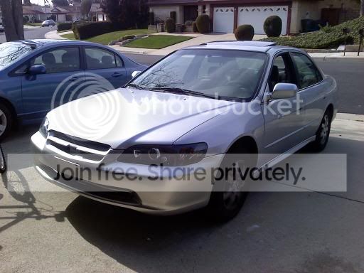

Car was finished today(just gota get the rad support replaced later) here are some pic's thanks to juicebox.
Total Cost:
350$ to get the frame straightened
460$ parts
Total: 810$ :chucklesfawk:

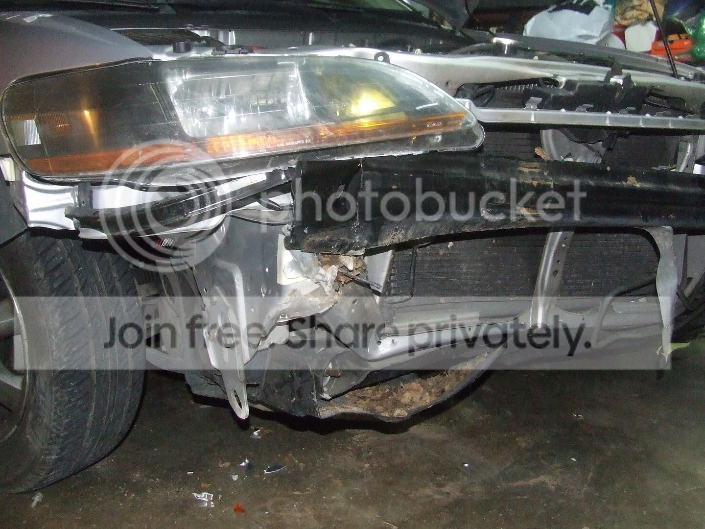

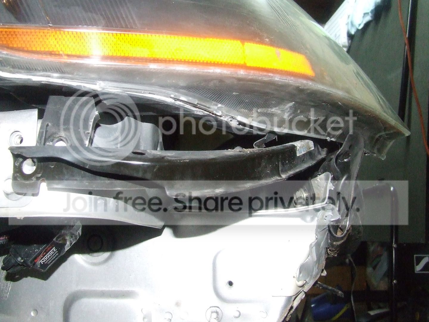

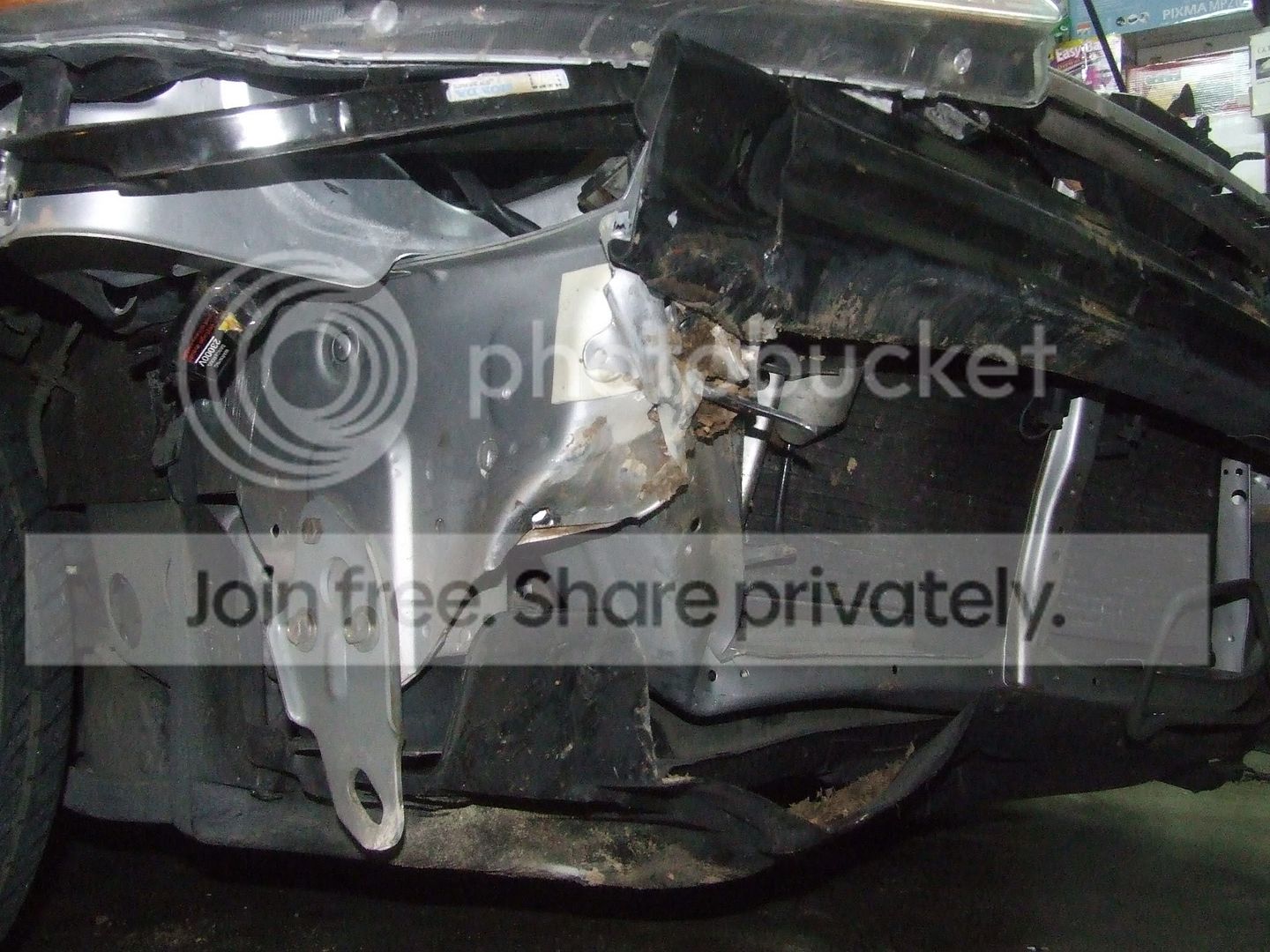

My tires are basically bald, the roads were moist getting back home from college. Here are some pictures :( :( Does anyone know how much this would be?
Car drives fine, it drive straight. I know the alignment is off, but from the pictures do you think it will be fixable under 1k? That's if I get the body done at a shop, but fender/ bumper / headlight I do on my own? All input is greatly appreciated.

Hate to be the bearer of bad news but you need more parts than you think. It looks like your rad support, bumper support, headlight support, basically everything in front needs to be replaced. You are looking at a lot more than $1000.

Yeah, it's all bent and it looks like even if you got a new bumper and everything, it won't just slide back into place. I would highly recommend against using a hammer and possibly trying to bend it back in place. The metal has already bent so it's weak and if you get into another accident, it might just be worse than before.
