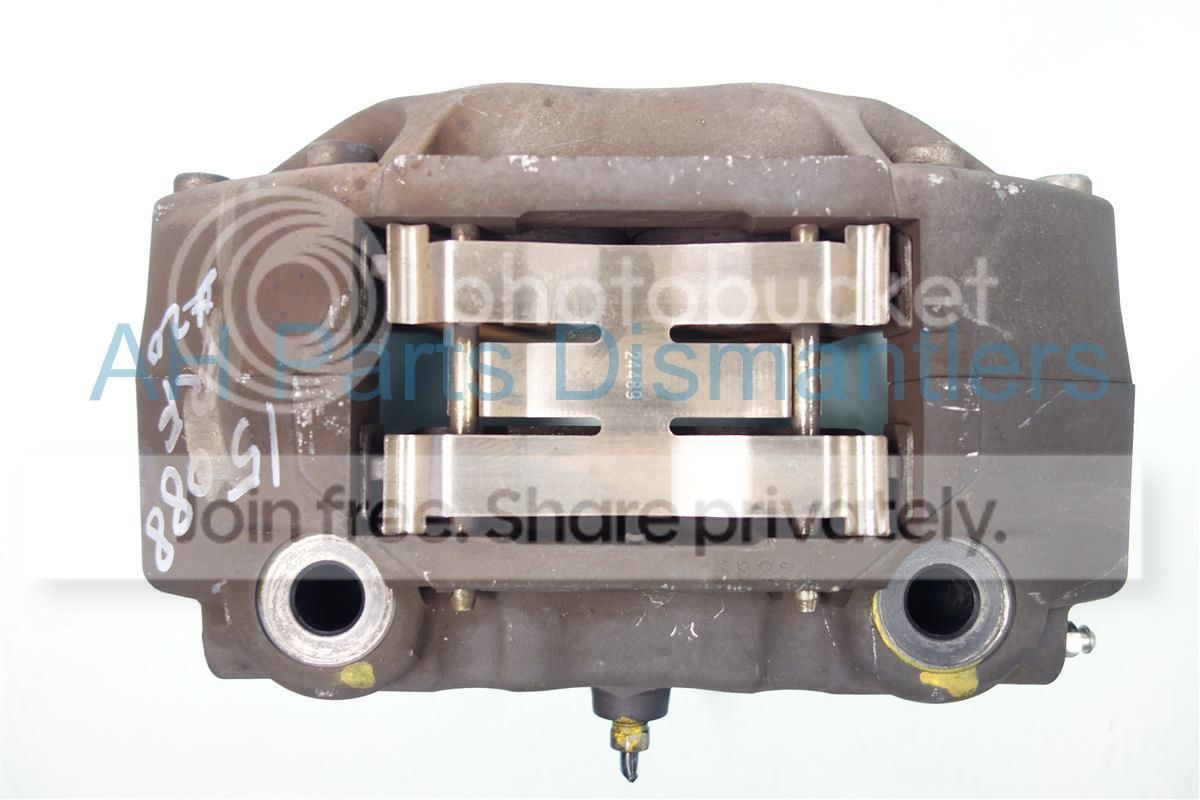

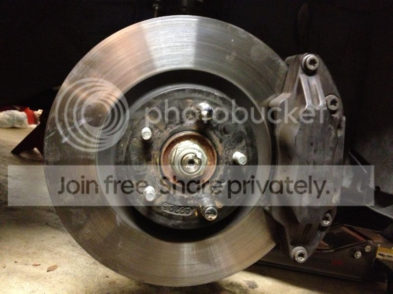

Are those RL calipers? I haven't heard of S2000 or G35 pads being used with them, but then again I haven't researched that setup in awhile. Last I heard people were using 350Zed rotors with the OEM RL pads.

I don't think those are RL calipers. RL calipers say Avid on them or something. Brembos are on the 3rd gen TL-S. Never heard of these going on a 6thgen but i've read people have put them on S2000's. For 50 bucks its worth a shot!

^You're right the ACURA logo is too small to be the RL Brembo's, or TL Brembo's for that matter. Maybe an older design?

^Hmm maybe. Excited to see how it turns out. Should be an interesting setup

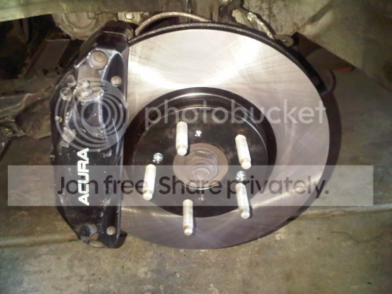

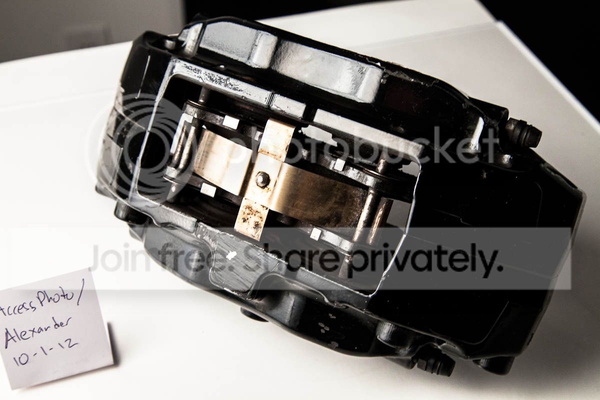

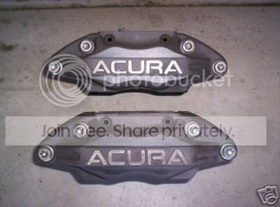

I pulled these right off the car it was 06 TL-S if you google 06 tl-s brembo they are exactly the same. RL calipers use different mounts that require the bracket which is a better mounting system IMO, these calipers basically are the bracket and mount right to our existing caliper bracket mounts, I'm reading how a lot of people have the same problem with stripped thread due to steel bolt on aluminum caliper and the elements it makes them almost fuse together.

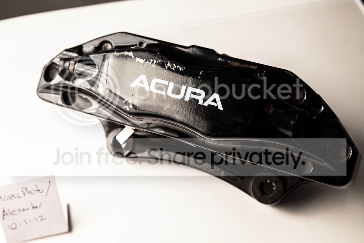

So here is the 2 different brembo calipers offered by Acura.
Acura RL top mount calipers.
TL-S calipers rear mount
Now u can see the differences in the 2

^Thanks, I guess I did not realize or ever look closely enough. So it sounds like the TL-S are more of a direct swap...the calipers bolt onto our hub so you just need the calipers, s2000 front rotors, and Infiniti G35 pads? And just use the stock 6GA bolts? I wonder why people started flocking to the RL setup which needs a custom bracket...maybe they are more readily available or something, or cheaper.

I think the RL calipers came out first so people got a jump on using them, they also look smaller IMO allowing for more wheel options. Bad thing about the TL calipers is the bolts seizing and stripping out. These calipers (TL-S) are huge, it kind of worries me. :banghead: Might need like a 25mm spacer but that's gonna push my rims out quite a bit, I am so determined to make these work with my wheels. Camber kit! anyone know of a good one for the front? I found an Ingalls one on CL guy wants 150, I haven't look into them yet. Any input would be cool. It just came to my mind that TL I got these from has the best OEM front sway bar, I should go back and haul it out..
