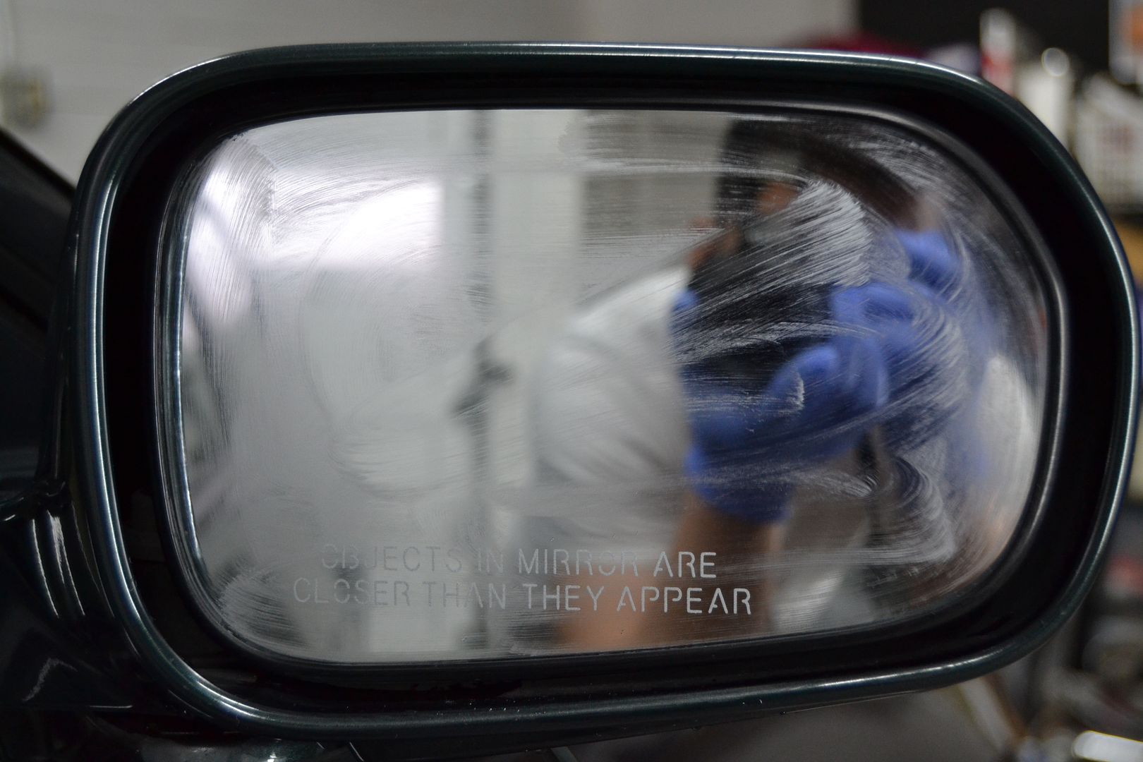

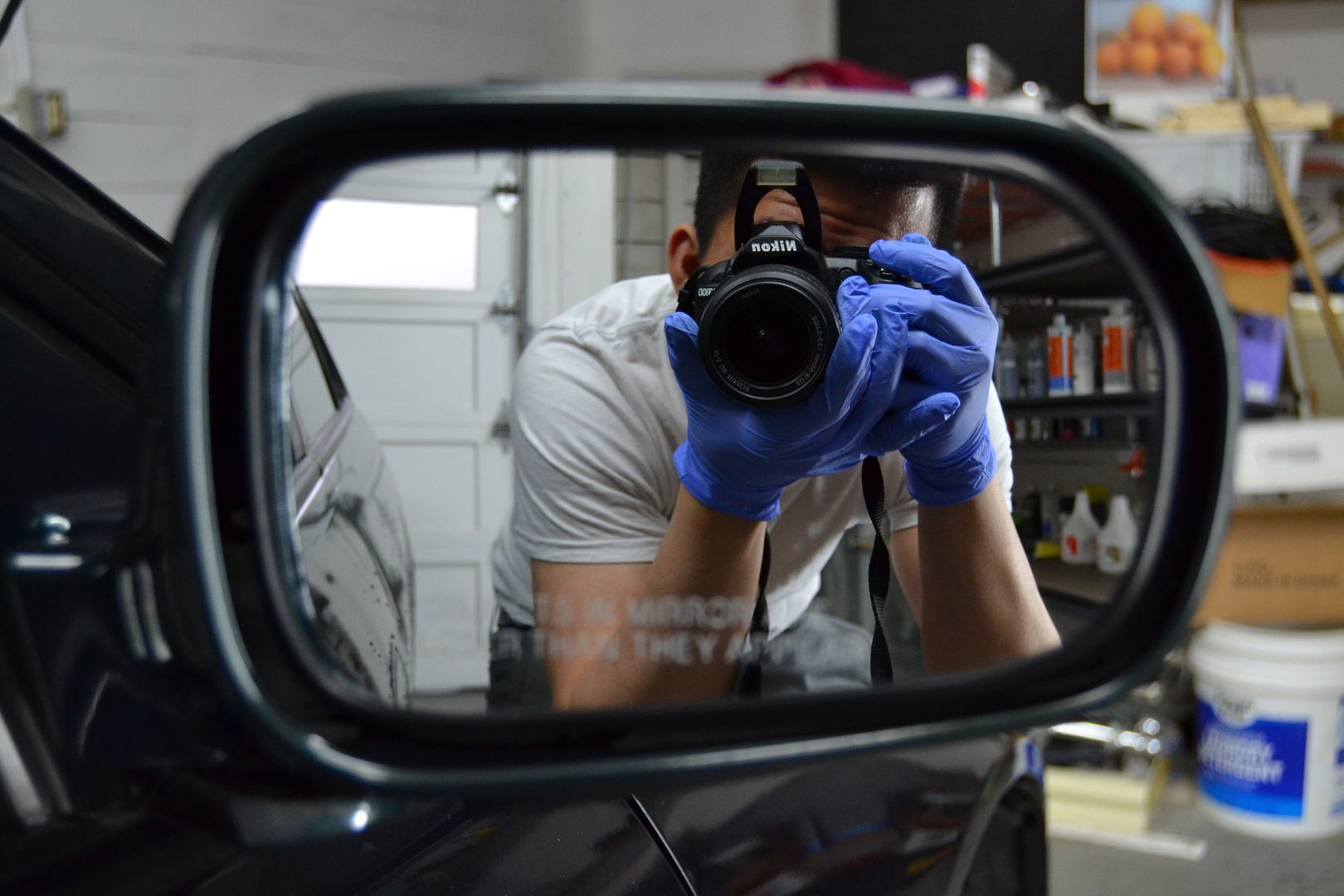

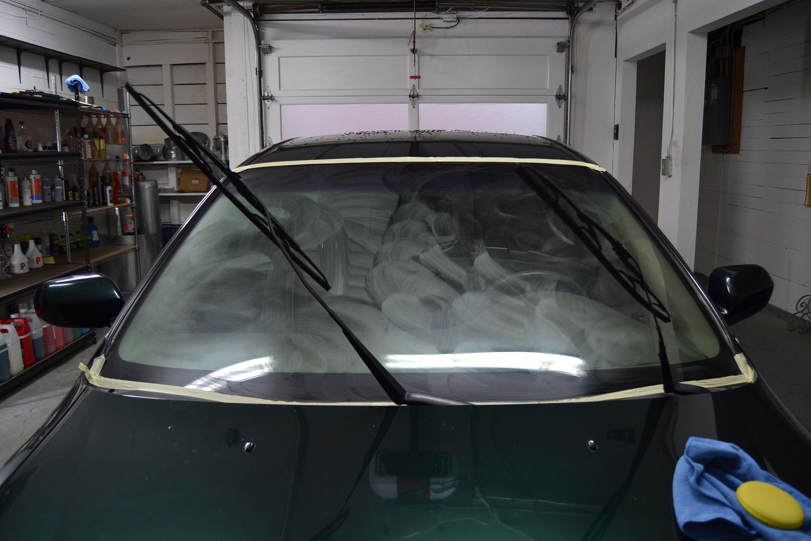

Coated all exterior windows with a glass coating by Gtechniq
Did all side mirrors with Gtechniq G5
This is what G5 looks like while curing
After buffed off within 2 minutes
Water repelling shot
(reserved)
Products used
Process for side mirrors:
Clean with soap and water
Clayed with Nanoskin sponge(fine grade)
Polished with Gtechniq G4
Coated with Gtechniq G5

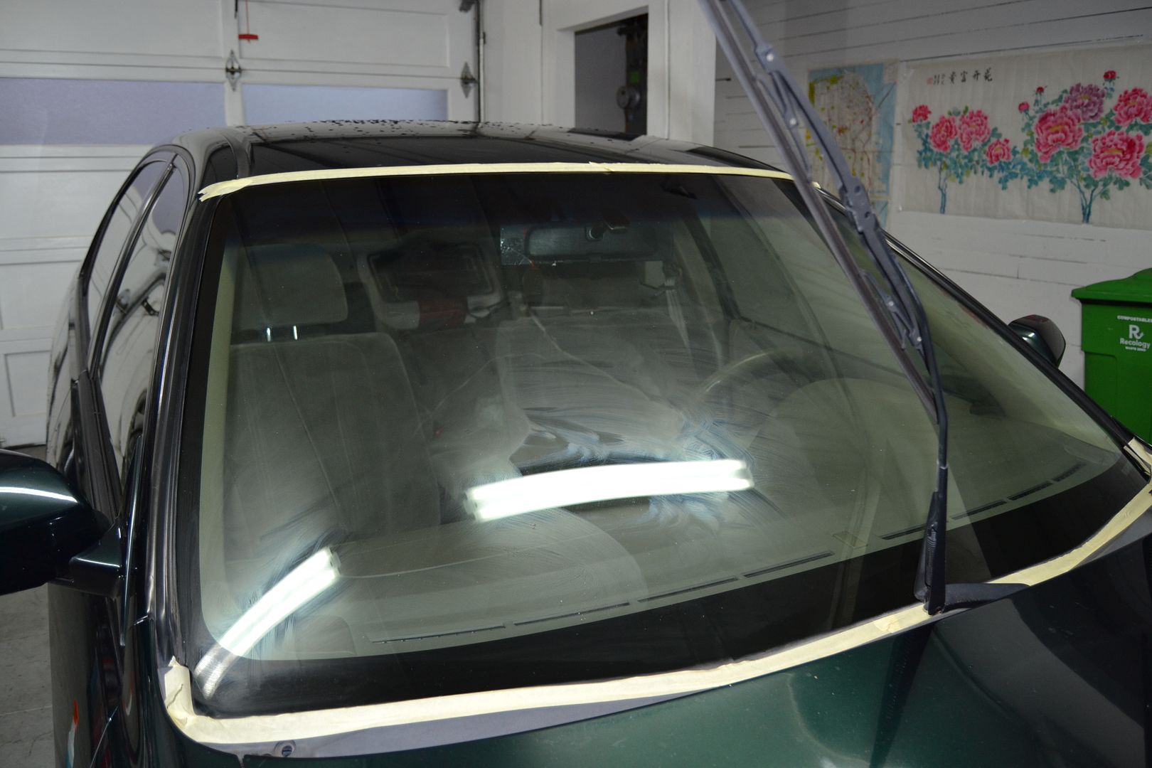

The rest of the exterior windows I coated them with Gtechniq G1

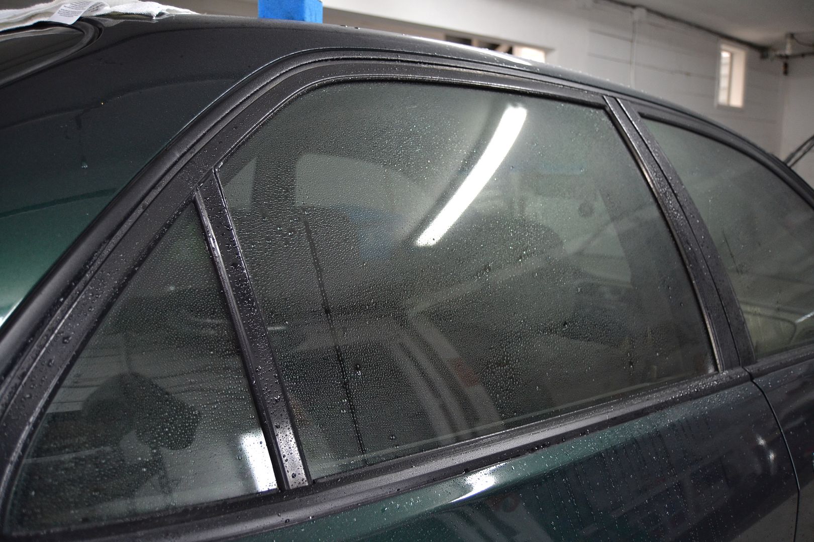

Here's a picture of the window without any coating. As you can see the surface holds water really well and it does not slide off.
After
(reserved)
Cleaning the glass with Gtechniq G4
1st of 3 layers of Gtechniq G1 being applied and allowed to cure for 5 minutes between coats
After
(reserved)
Products used
Process for all windows coated with Gtechniq G1:
Cleaned with soap and water
Taped up trim to prevent staining from products
Polished glass with Gtechniq G4
Applied 3 coats of Gtechniq G1
Buffed off residue using Gtechniq G2
Thanks for looking guys. If anyone have any questions with the products feel free to ask, or leave a comment.

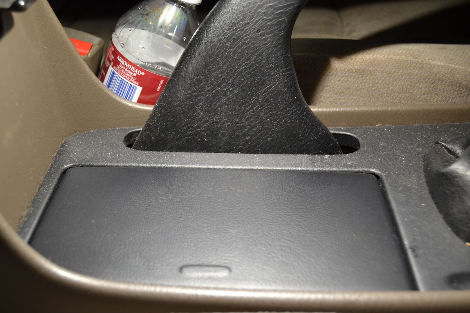

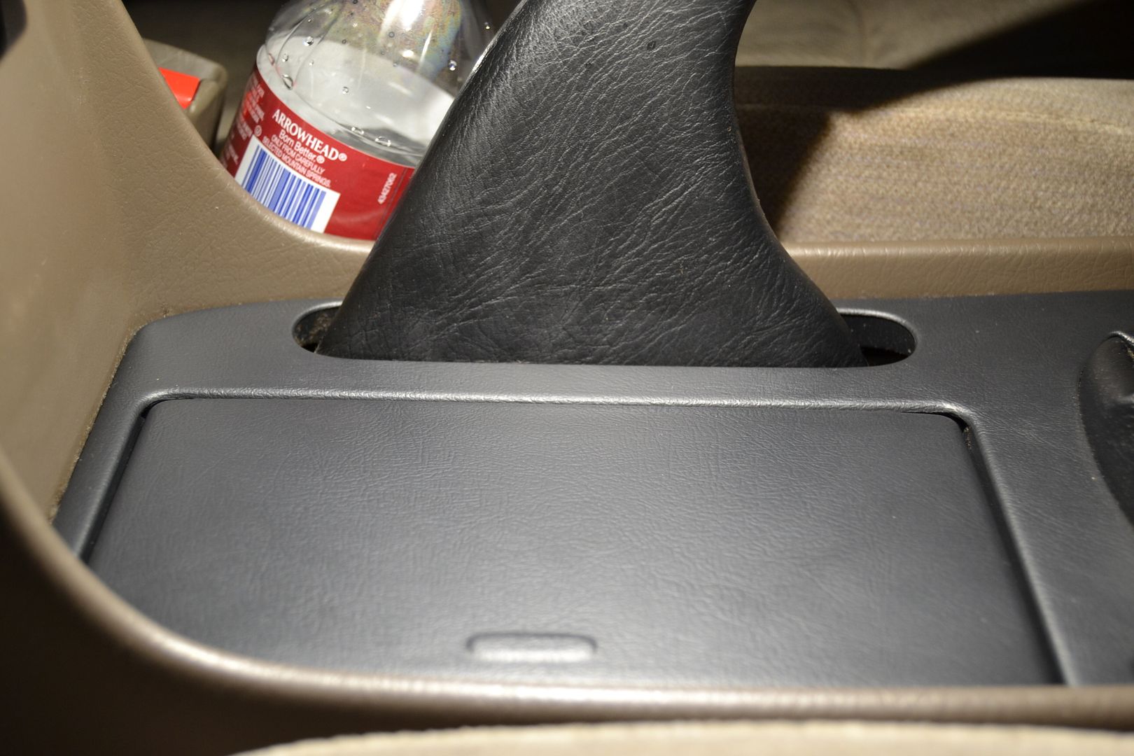

Couple spray at a time onto a towel. Then wipe the surface you are working on. Buff off after to get a matte finish look.
An example:
