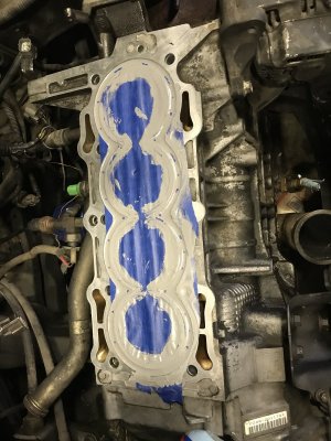

It’s been a while, but I’m just starting my build. Using this tread as a template. Anyway, how’s the engine holding up?
Did you ever consider a block guard? I just made one using devcon.
