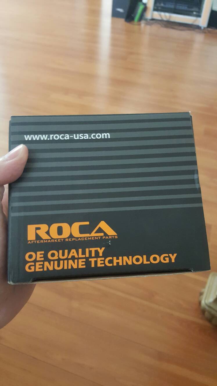

Got the end links and tried to install it. Turns out its rubbing on the exhaust hanger too so I can't get the end links in. Gonna get it relocated to make room. On ebay there is a company names ROCA. They make pretty good stuff. I bought a full engine and transmission mount kit from them for my V6 and the quality and packaging is good. Before I bought the mounts I researched them and they seemed to be popular on the mazda forums. New end links are solid so if you guys looking for anything check them out on ebay. Super cheap but well made!
