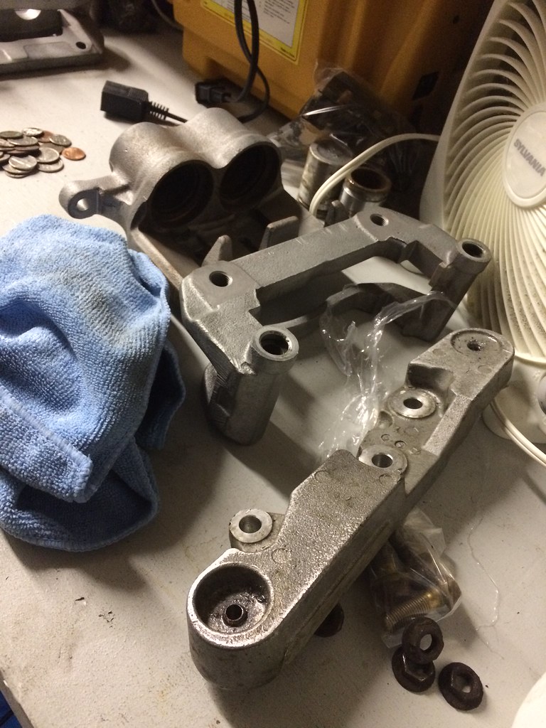

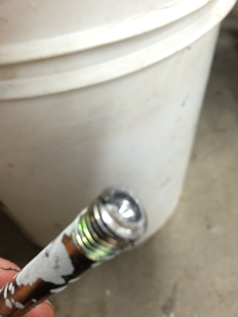

So I don't know if I need these things, but I bought them anyway. A Manual CL-S Fuse Box and a Manual Trans crossmember, with the old mounts attached.
Tried to take the old mounts off today and install the new ones, but both bolts broke off in the crossmember. So in the process of getting those tapped out.
Untitled by Evan Aschbacher, on Flickr
Here you can see the crossmember next to my Legend calipers that need to be powdercoated
