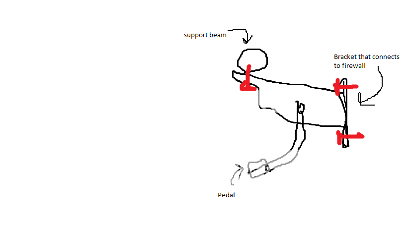

I couldn't find the thread. so i made a sketchy replica. Basically you need to reweld that bracket that connects to the firewall, and then drill a smallish hole in the support beam that runs across underneath the dash and screw a bolt or something up there. It's a bit of work, but it has held up great for me!

thanx guys for the help. i did put on the bracket suport i just screwed a nail up there and the bracket is now securely in place. however now that i did that my engagement is way to high and my clutch is slipping like crazy and it still cant get into gear.
