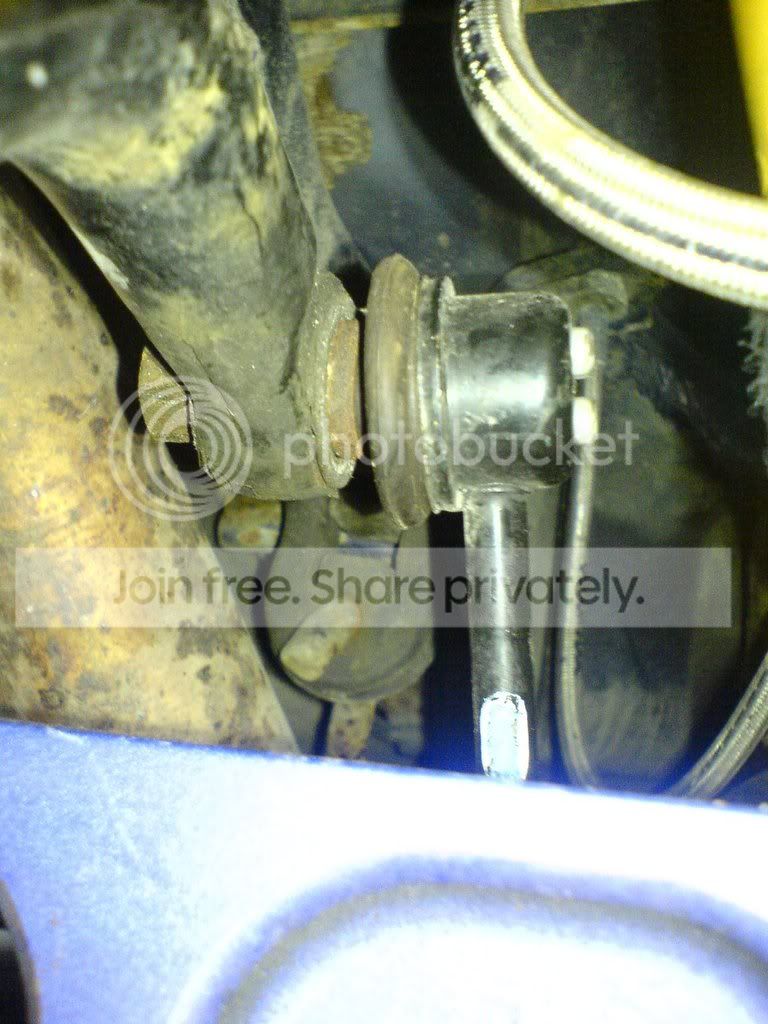

That is correct, as far as the swaybar is and mounting is concerned. You will need the endlinks too (21). I wouldn't buy the OEM endlinks. Finch said they are solid steel. Yes they are, but not the point of connection - the joint is plastic, and those 4 dots you see on the socket are plastic pushing through. I used a hammer to brake the plastic casing to get the old linkages off and then vicegrips and a ratchet on the other end to get the rusted bastards off. For an OEM quality part, I think Honda failed on their endlinks. Get Moog, and for en even cheaper price. They have a grease nipple and a nice rubber boot protecting the joint from the elements - something Honda didn't realize to design.
This is picture of the OEM endlink - the two dots you see on the end of the link is part of the plastic joint capsule.
The way it's held in is plastic. Honda inserted the capsule, then melted the tips (4) of it to prevent it from sliding out of the steel housing.
Thanks for clearing this up, I didn't know this was what you meant by solid steel. If the Moog ones are solid, go with them for sure, I would've if I knew before I bought OEM ones. I haven't had a problem with the OEM ones breaking, but Moog is the obvious choice for price and quality.

That's how the OEM ones usually break - is the capsule disconnects from the steel housing, and there's no 'fix' since it's molded like that from the factory. Glad that helps :thumbsup:.
