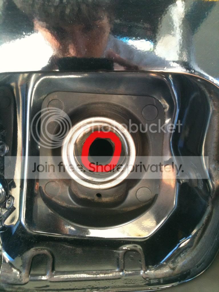

EDIT: Also realized something the other day while I was getting gas. Shouldn't there be a little protective flap that the gas nozzle has to push to pump gas? I know my CB7 has it, my dads tundra has it, and like every other car I have ever had to put gas in has had it. Can't recall if my CG has always not had it. Question is, do our cars have it, and if so then where did mine go?
Should be like a little metal plate inside of where I painted red.

Yes, that's the roll over valve, for when you are flying inverted. Lost ours many years ago - must be in the bottom of the tank somewhere.
I was filling up our '09 XB at Fry's and noticed that one has fallen into the tank also.
