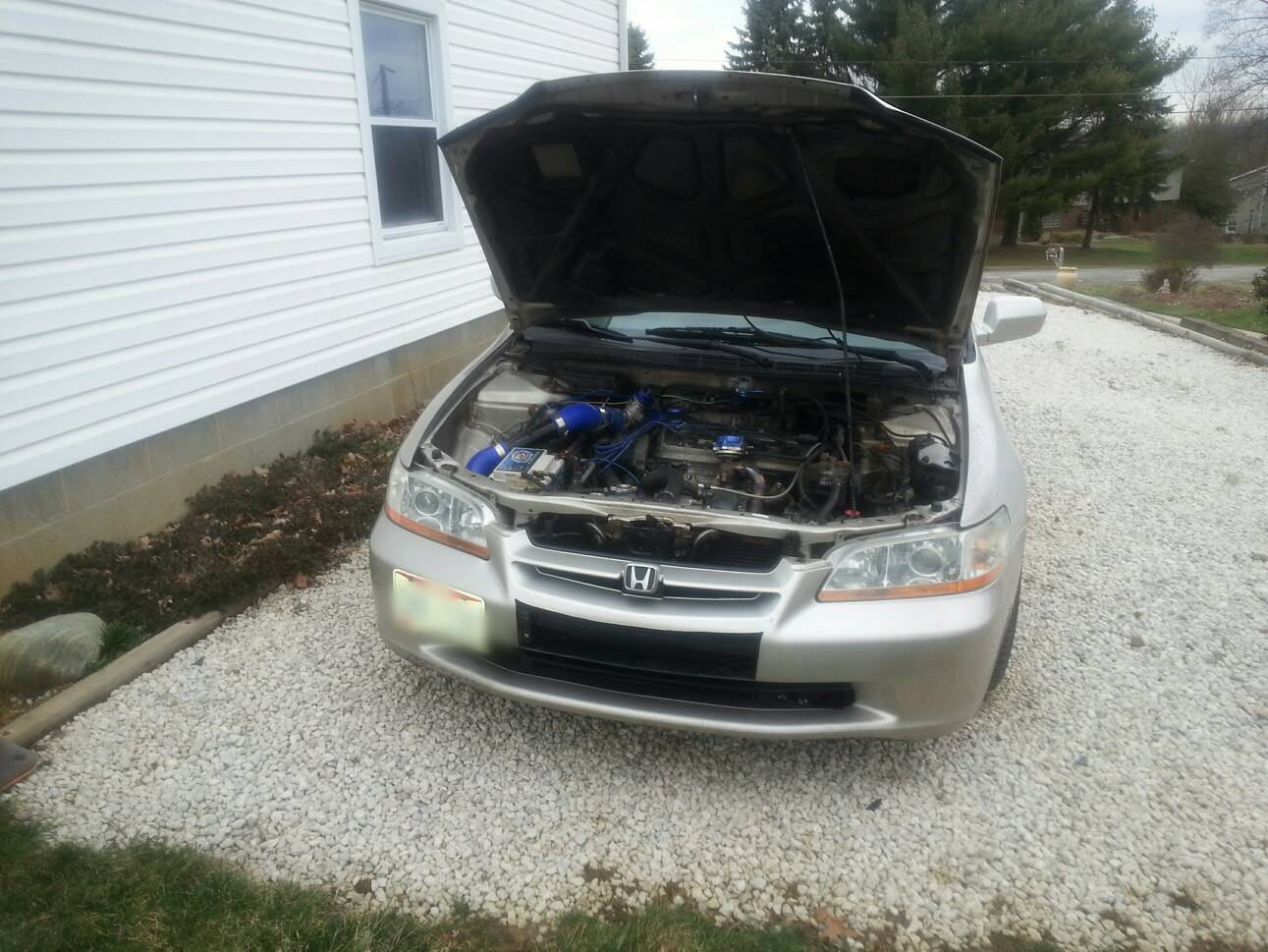

I figured Id post the pictures of what Ive been doing recently. I started out completly redoing the exhaust and using a varex muffler as well as bracing the exhaust to the engine better.
Then while I had the turbo off and had some spare stainless laying around I decided to make up some intercooler piping
Old style
new style
On car

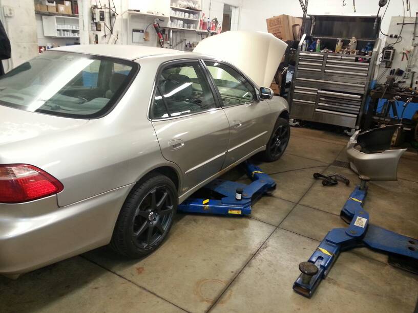

My new wheels
And how car sits (plus a shot of the equipment I get to use. I am very fortunate I know)
The control arms
And the current Alignment (if anyone's interested.)
