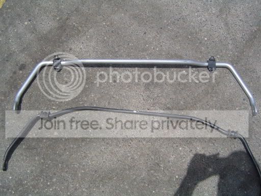

oh well at least I got my comptech 22mm rear sway installed. Yeah and the endlinks are rusted and stripped now too, so I guess im gonna have to add new endlinks to my list :mad:
who said size doesnt matter?
