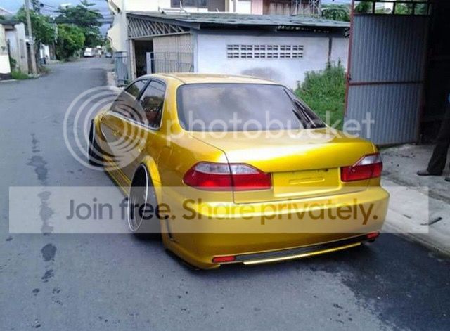

There's a sedan somewhere in Asia that has a fender flare. I'll try and find pictures. I know I've seen it on Instagram
Edit: found 1
Edit: found 1

So are they full metal flared guards On the gold car you posted?? Not river-on flares
