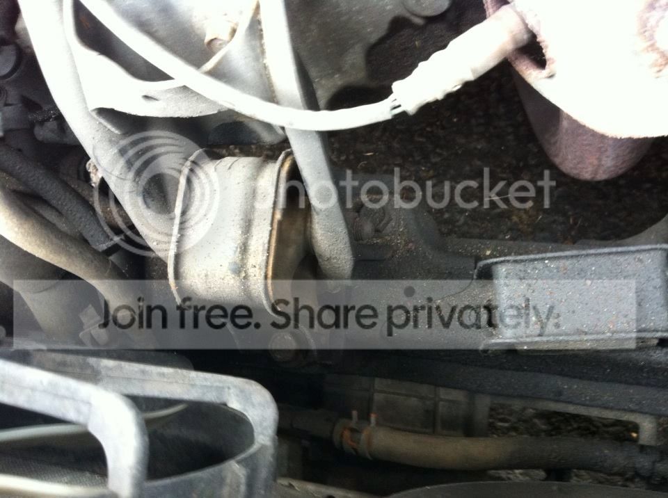

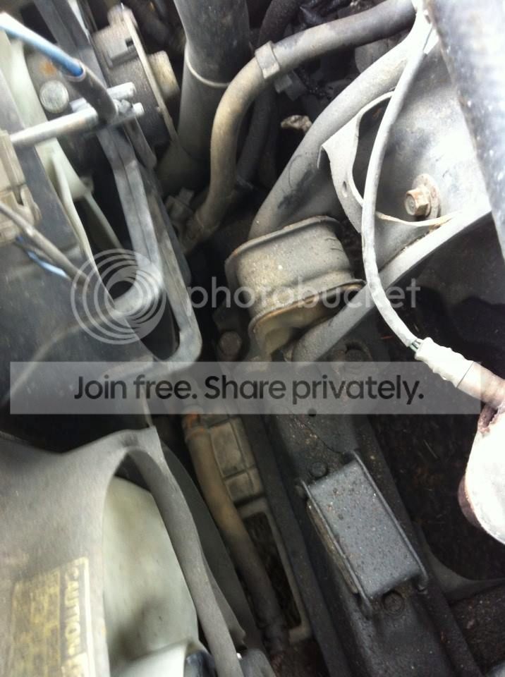

After doing some few more check ups, i think the issue is the engine mount. Finding out the defective one is the hardest part.
Every mechanic is telling me something different but one of the mechanics that i trust the most said he was leaning more towards engine mount than transmission.
I've tested it at home, switching gears between R to D and the engine seems to move forward easier than usual.
If i press on the brake pedal while giving some gas, the engine seems to move there as well. Gives me the feeling that something is loose
Also, during stops, i feel a little vibrate, like it's about to shut off.
Here's few pics
